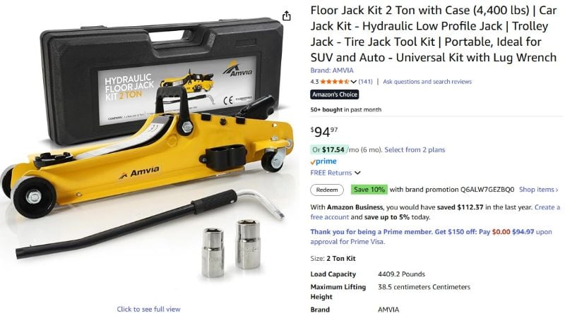

I had a very similar experience earlier this summer on a busy section of highway in the middle of Detroit with only a very narrow shoulder.
My scissor jack would not collapse low enough, so I had to call a friend to bring his floor jack to me. Essentially sitting on the rim, I measured the clearance between the concrete and the lift point of my 2021 320S (non-boondock). I determined that the jack had to be no taller than 3 1/2" in the collapsed position. Again, this is a 'non-boondock' model so I'm guessing this would be a 'worst case' scenario for the 320 models.
I have since bought a small floor jack from Amazon. It drops to 3 3/8" and comes with a nice, clean carrying case.
Thanks for this. I think my floor jack is a similar size. If you know what you’re doing there are other points on the steel frame where you can set the jack that will give you more clearance than the designated lift point but having a jack low enough to get under the lift point would be ideal.
