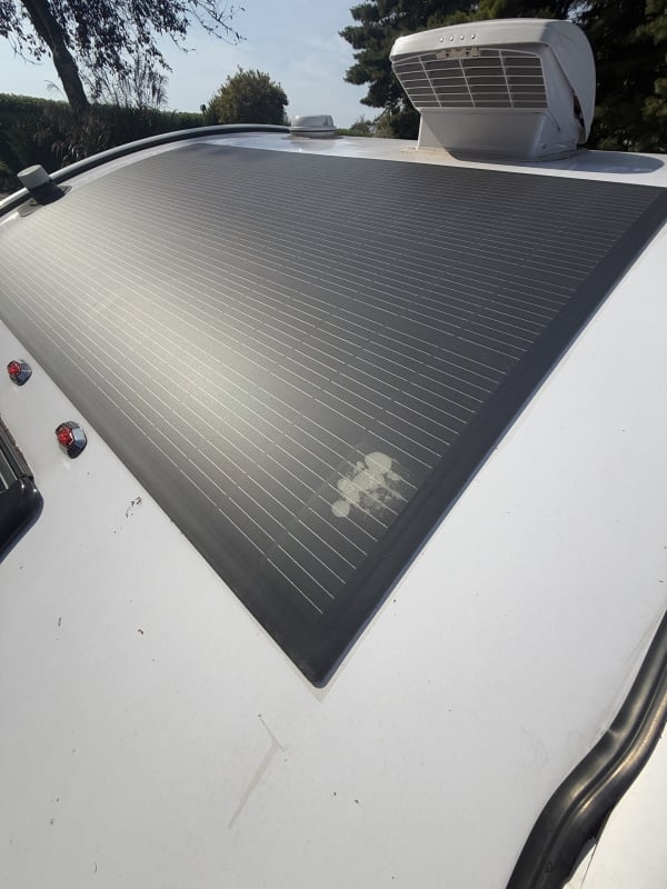

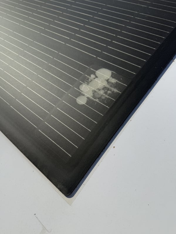

Welp …….. update on the newest 310w panels . We now have 2 of the newest 310w panels on our 400 . Our "new" 310w front panel is holding strong at about 1 year old since installation . Unfortunately our "new" 310w rear panel is already failing at only about 3 months since replacement at NuCamp . Still working ok, but beginning to blister and show signs of possible hot spotting . Still waiting on Nucamp about replacing this panel that was just replaced in July .
These are the newest 310w replacement panels that have replaced the older defective 310w panels.
Pics ……….
