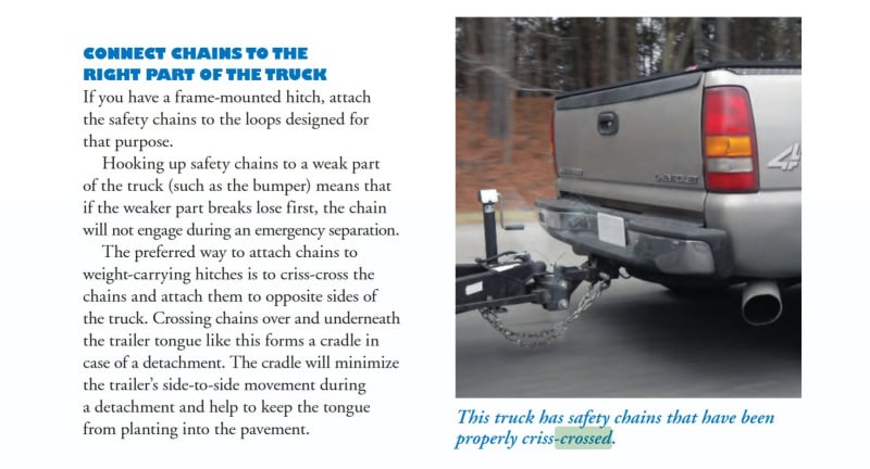

    It is a misconception that the safety chains will prevent the trailers coupler from contacting the ground.
    When the coupler disconnects and drops toward the ground the trailer moves toward the TV and the chains easily allow the coupler to contact the ground.  A slowing TV will force the tongue even closer to and under the TV and the safety chains will become completely slack.  If the trailer brakes engage, the entire trailer moment of inertia is driving the tongue toward the ground.
    With the recommended 16 inch ball height and 26 inch chains connected 4 inches below the ball, crossing the chains will make no difference in preventing this.
    The safety chains are to prevent the trailer from careening off unrestrained and unguided.
    The safety chains, when crossed, form a cradle that supports the trailer tongue. If the coupler disconnects, and the distance between the vehicle and trailer increases, the chain tension will support the trailer tongue long enough for you to get the trailer/vehicle under control.  This is a section of the chain discussion from the Purdue Extension "Keep the Trailer Attached To the Vehicle" document that describes the chains and connecting the trailer in detail.
    The Safety chain discussion starts on page 42 of the Purdue brochure here.

    The length of the chains is clearly crucial, but properly placed chains can keep the tongue off the pavement.
    I had a large U-Haul trailer hooked up by the dealer to my truck, and the hitch disconnected less than a mile after I got on the road. I was on a long downgrade and the tongue went under the truck and tried to sway out of control but the crossed chains worked and when I got the TV stopped the hitch was resting on the crossed chains, off the pavement.

    Speaking from experience... it depends. If you're on an upgrade, the chains will go taut. And you should absolutely not hit the brakes on your TV (which would cause the trailer to ram into the back end of your TV). I came out of an incident at 60mph pretty unscathed because 1) it was an upgrade and 2) I took my foot off the gas and coasted to a stop.
