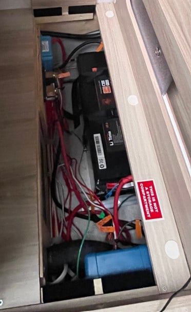

Hi,
I have the 360CS where the OEM 100 ah battery is in the front. I changed out to the 230 Ah LiTime battery and placed it in the rear under the seat back, where it is placed for the non CS model. I am very happy with the performance of the battery. I consistently get 50 amps of charge out of the OEM WFCO charger.
I cut the cover (over the entire rear area) into two sections. One that would stay over the AC and a second section over the area where I relocated the battery. Because you really do not need to go in there often, I thought it was fine. Instead of screws, I placed velco around the perimeter to hold the covers in place, but in reality..I think it would be fine w/o screws or velcro. The cover is recessed and not going any where.
I'm also on the fence to add an inverter or just use a Ecoflow or Jackery to power a few indoor kitchen items . The only thing I want to heat is hot water in a kettle and run the microwave for very short periods of time. Well within the the capability of those units . I have an 2000W Ecoflow. I installed an inverter and transfer switch when I had our 320 and although very convenient, I'm not sure all the work and expense is really needed for the little non shore power we need.
All the AC circuits come out of the WFCO. There is an extra slot you could use to place an outlet in the kitchen area. I would guess the wattage of a Blackstone is in the same range of a hot water kettle (1500 or so) but would be run much longer for cooking than just heating water up. Here are a few photos that might be helpful.
