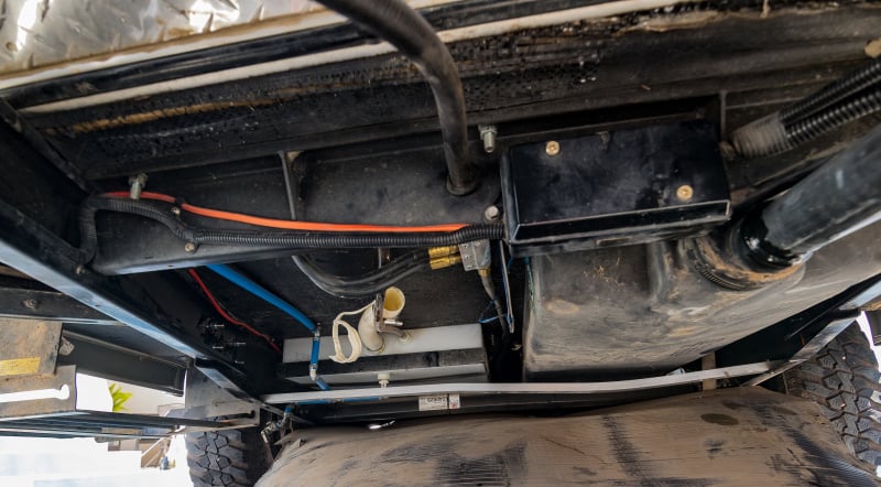

    The photo below is what the water tank looks like in my 2017 "non" CS.  Pump in the front above the toilet.

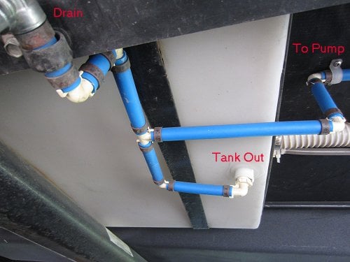

    This photo is from the front of the trailer under the tongue.  The step is to the left part of the photo, and if you look closely, you can see the fresh tank drain.  The blue pex coming toward the front of the trailer is the pipe that comes from the bottom of the tank where water is drawn out of the tank and up to the pump. From another thread in the Forums, that little setup looks like this, below. Taken from just under/behind the front step. There is only one "tank out" port, and then the pex is set up to both drain the water tank and send water to the pump when requested.
    So, I don't know where  your pump is, or where your fresh water tank drain is,  But, if the pump and the drain are in the same locations, this would be what to look for in a new water tank. Someone might have to configure the plumbing to connect the drain (or work out a more convenient drain location!).
