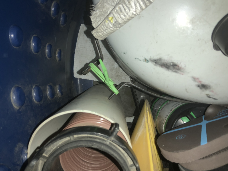

    @MOS2, I experienced the same issue you describe. My solution for the last 3+ years is to use a removable zip tie.  In my case, I discovered the tank didn’t really need to be held tight I place just secure.
