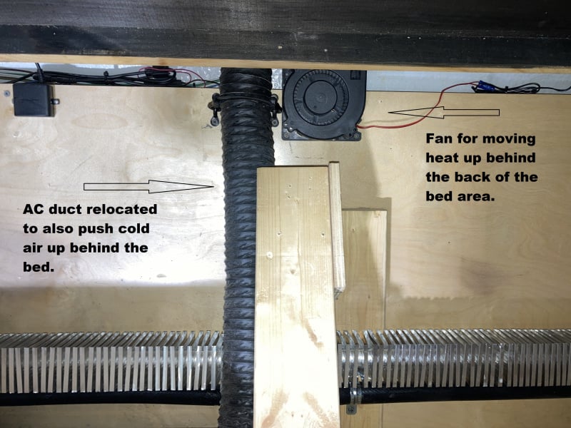

    As for the fan, I added one to force air up behind the gap at the rear of our 320. My first attempt had it wired to the furnace so that when the thermostat called for heat and the circulation pump went on it would also activate the fan. That did not work great. It would start blowing before the convectors got hot, blowing cold air. Then when the circulation pump stopped the fan would stop even though there was heat that could have been distributed. I ended up wiring an independent on/off switch.

    Here's where I mounted the fan.
    (note that I've moved the convector lower)

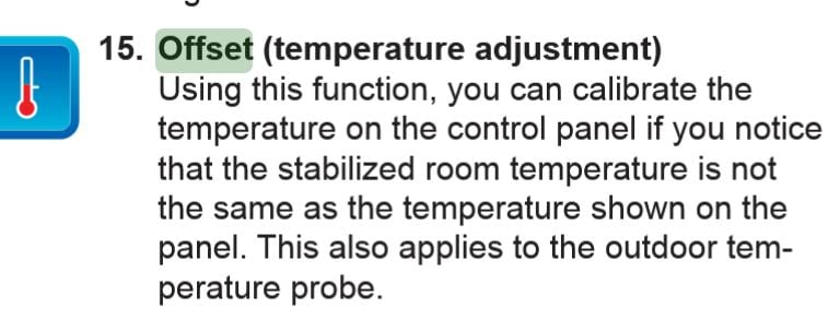

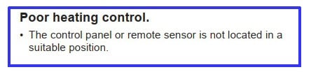

    There are a couple of other things that can be adjusted.  The thermostat for the Alde is in a nice, warm, comfy spot on the circuit board inside the Control panel.  If the light on the control panel is on, that can influence the temperature the Alde thinks the cabin of the trailer is.  What you are hearing (the Alde turning on and off) is normal behavior.  You might have asked for "70 degrees" for a cabin temp.  The Alde thermostat gets to 70 degrees before the cabin does, and shuts off.
    What the Alde has to help with this situation is the "Thermostat Offset" procedure in the manual.  You will need to have a separate thermometer that you can compare the temps in the cabin to what the temperature the Alde thinks the cabin is.
    There is such a thing as an Alde "Discrete Temperature Sensor" that gives you more control of where the temperature is measured, which, in theory, will help quite a lot.  Most of these parts are available in Europe from suppliers.  In the USA, Alde...not so much.
