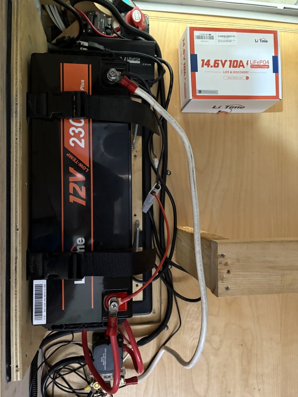

    qhumberd Administrator, Moderator Posts: 914
    The lithium batter apparently likes to get a 100% charge from time to time to balance the cells with its built in battery management module (BMS).
    If your solar controller is set to Lithium you should be fine, and a small plug in charger when you are on shore power or storage away from sun can do the rest. We got a 10 amp Lithium from LiTime for ours and it rests right next to the battery.

    There is discussion about whether it is necessary to disconnect the battery from the WFCO when using a dedicated lithium charger. I do with mine simply to ensure the charging profile is correct for my new battery as I have the non lithium WFCO and no roof solar. Others with roof solar have indicated it doesn't cause any issues. You disconnect your batttery from your WFCO by using the battery disconnect switch, and in my case the small charger remains connected to the battery and only needs to be plugged into shore power to charge.
    I also have the 230 amp hour LiTime version, but except for the capacity everything else is the same for your setup.
