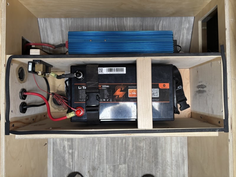

The LiTime 320ah smart mini fits perfectly in my 22 Tab 400 Boondock original battery space. Added Victron lithium
smart charger, second Victron solar controller for the external port, and Victron Smart Shunt. Hope it gives us days of off-grid fun. Kept the 1200 watt Inverter as not looking to use any high draw appliances. 1 -

Finished install of the Li Time 320 mini. I made the compartment one inch wider to give it a little breathing room and put some blocking in to keep it from moving around. I installed a 20 amp charger in the side storage compartment and will use it when on shore power with the battery switch off. Also made some adjustments to the WFCO and solar charger.
