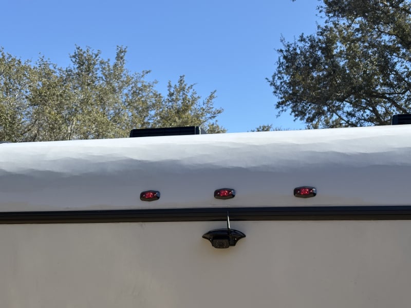

    Wrinkles in the crown on the roof (this is the area at the end of the roof as it curves downward).  The wrinkles were not there when we picked the vehicle up.  This repair will probably require a new roof according to nucamp.

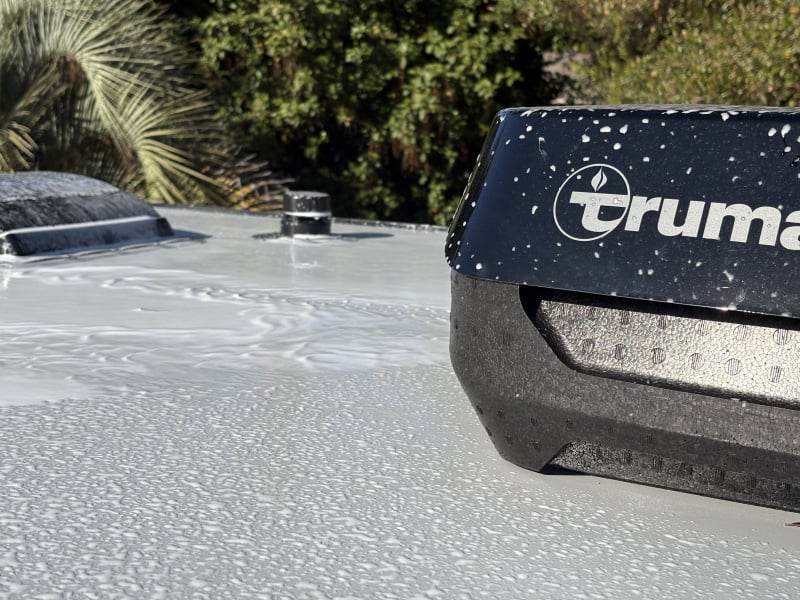

    Standing water on the roof.  Rained on a Friday, Sat no rain, packed up Sun morning and when I raised the tongue to connect to the tow, water rain off the back.  Not a little bit but probably about a gallon.  Not sure where the water is pooling/standing.
    Inspecting the roof using some soapy water after the above and notice air escaping around the both the driver's side and passenger side of the roof a/c.  Not sure if this is normal.  Unit did have power and the a/c was operating.  No interior water damage observed.

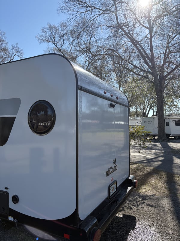

    There are two things we don't like...the Haven sits low...It has two V shaped brackets in the back to prevent the rear of the trailer from rubbing.  I've hit those multiple times.  I'm going to check with our local tire dealership and see how much larger of a tire I can mount to give us a bit more clearance.  Last, the bathroom door.  They should have made a pocket door.  Door opens towards the exterior door and is just awkward.  My wife had me remove it and we hung a beaded curtain.

    Hard rain last night.  Checked the roof and yes, standing water on the drivers' side by the solar panel and a/c.  The water is being held in place by the bundle of solar panel cables.  Once I raised the front high enough, the water flowed over the cables.  I just ordered from Amazon a cable management kit with UV protection.  Basically, they are small squares with a raised center that you can connect a flextie to.  You lay the solar cables on this and secure them in place.  The small gap between the cables and roof should be sufficient to let water flow under.
