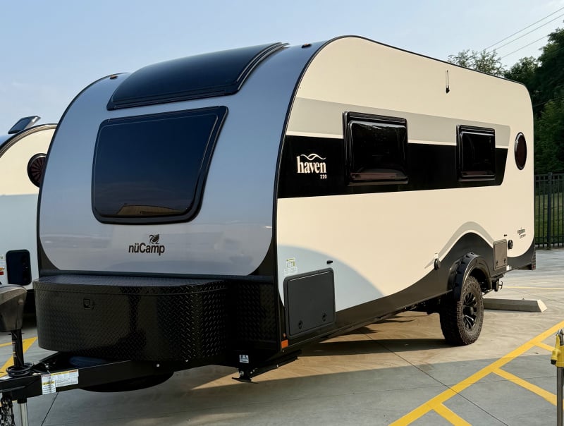

  • B0atguy
    B0atguy Member Posts: 269
  • Blueespy
    Blueespy Member Posts: 288
    Without knowing what's inside, I'm going to take a guess and the exterior difference is a 2-3" pitch axle to give the Haven more ground clearance. We had 3" pitch installed. Do you remember if the boon dock option had the upside down triangle drag guards on the rear?
    Haven 220
    2026 Ford F150 Tremor 5.0
    Niceville, Florida
  • B0atguy
    We did check out the interior, and it looked like a standard queen Haven 220 model . I do not remember 100% , but I think it did have the drag guards on the rear like the standard Haven 220 .
