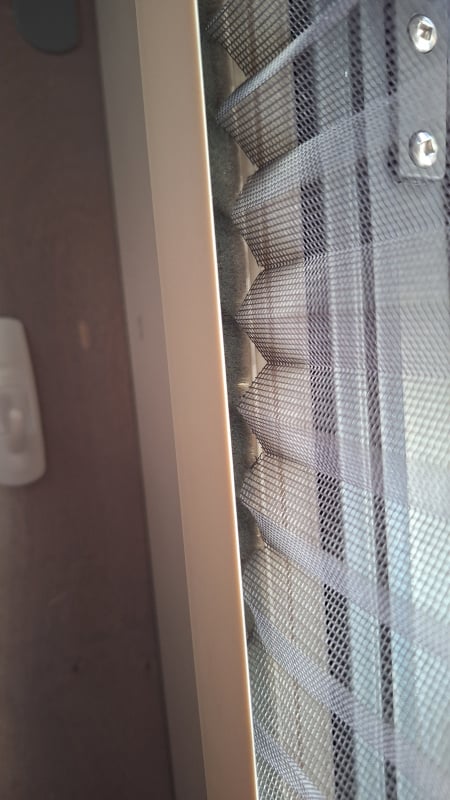

First Problem that I have found that when deploying the bug screen, on 2 of our 4 windows, that the bug fuzz on the side channels don't work because the screen unfolds to the side of it. So for those 2 windows, I've found if you lower the screen slower it does better, but I need to pull the vertical string that runs through the mesh to align it better.
The peaks of the screen should be flush with the plastic frame to function the best.

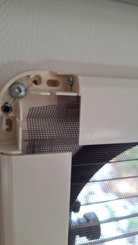

The third problem I found was the corners of the window screen, especially the upper corners. When the screen is deployed, those corners become empty and the mesh is not attached to the frame. Bugs easily go around that and into the camper. This is where we really noticed the little bugs coming in.
Here's the issue:

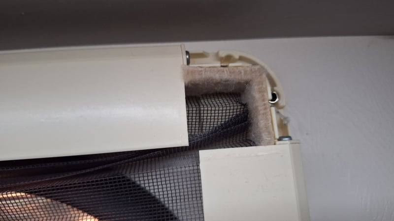

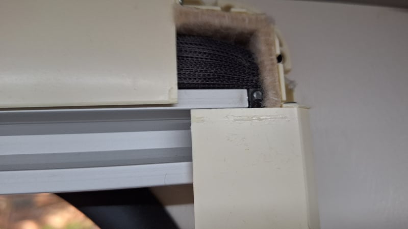

To leave room for when it is folded back up, I used furniture felt pads on 2 sides of the corner, one sticking the mesh to the top of the frame, and the other on the side. The window screen still retracts fine:

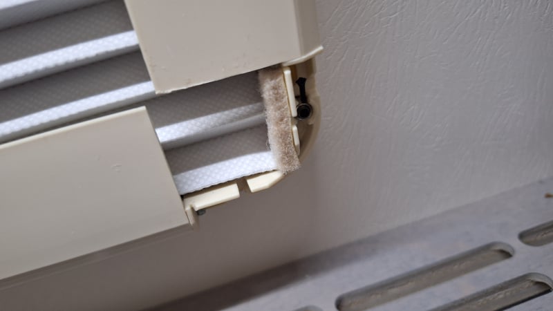

Finally, the bottom corners aren't as much of an entry point, but I found dead bugs in the corner cap, so I put one piece of felt to block it some. Since the bugs were dead, I'm assuming they mostly didn't escape these corners as much.
Here's the issue:
