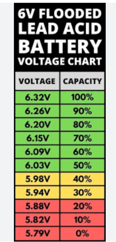

Below is a 6V battery "state of charge chart". Keep in mind: if these readings are all from batteries that are being charged, the voltage will be showing artificially "higher than actual state of charge." The only way to get a reasonably accurate voltage from a lead acid battery is with the battery switch off, and no charging coming in.And, apparently you have a multimeter and know how to use it!
