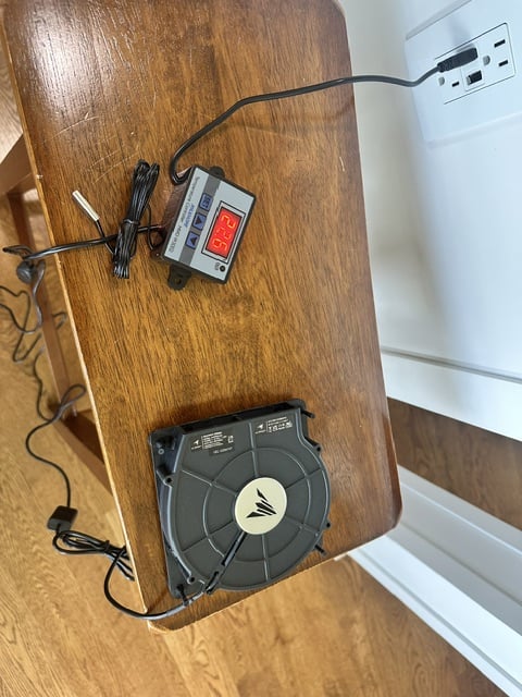

Finished the upgrade.

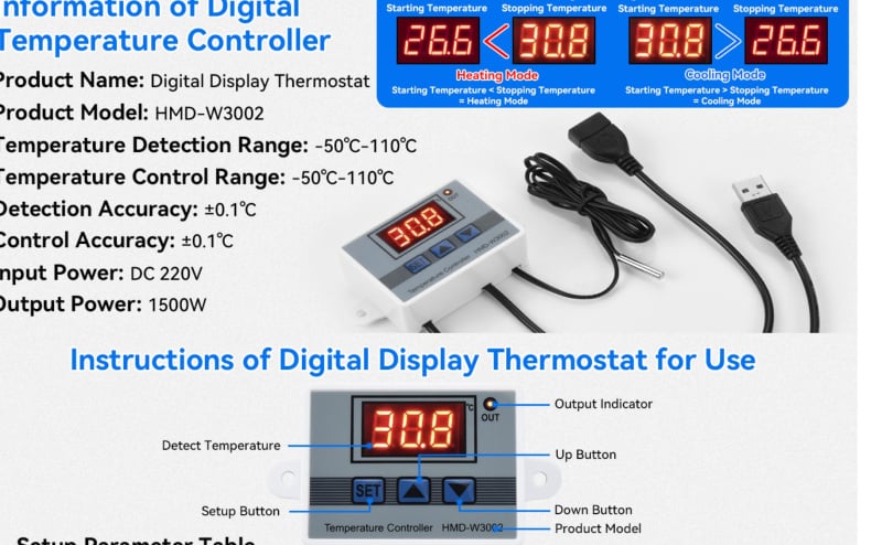

Amazon.com: ELUTENG USB Fan 120mm with Digital Temperature Controller, 5V USB Powered PC Computer Fan 1500RPM 3 Adjustable Speeds Electronic Cooling Lufter with Metal Grill for Laptop/TV Box/AV Cabinet/PS5/Router : Electronics

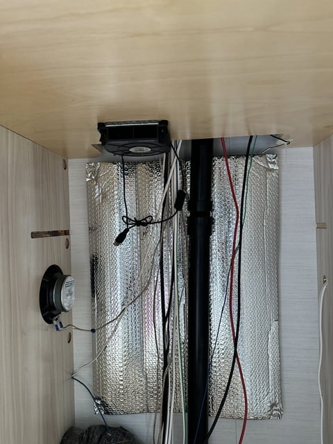

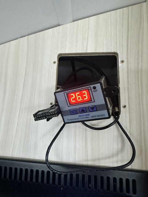

Used this controller but not the fan. Can buy controller only but its in Chinese and with out fan for only 3 dollars cheaper. This version is English but its easy and could have used the Chinese version They are both in deg C. I have it come on at 88 deg F and turn off at 84 deg F. Just laid it all behind stereo and if need to adjust fan speed or temp settings can just pop stereo out.

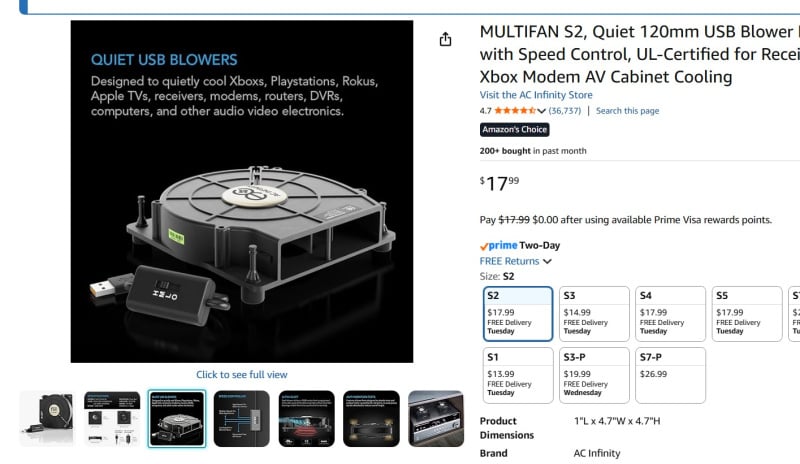

I used this fan instead as needed to fit above fridge. Did add some material and double sided tape above the outlet duct to act as part of air duct and limit recirculation.
Amazon.com: AC Infinity MULTIFAN S2, Quiet 120mm USB Blower Fan with Speed Control, UL-Certified for Receiver DVR Xbox Modem AV Cabinet Cooling : Electronics
Pic shows thermocouple in back but it is to high in this pic just near compressor. I went back after testing and lowered about 8 inches placing also more center of cabinet. Working much better giving more accurate read of cabinet. After a smoke test appears I am getting a good draw across top with fan on speed setting 2 which is aprox 20cfm. Hopefully this will help.
In addition applied some aluminum spaced about 1inch off back wall to try to cheat out a few more deg when sun is sitting on camper while going down road. Also found that the cut out in the wall for the antenna is a 3 inch cut out (not shown in picture but you can see it in top right if you stick your head in the cabinet). They removed the entire insulation for 3 inches. I added a 3 inch round hard foam board insulation back.

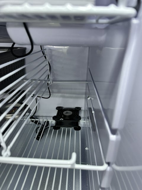

Also added the 80mm version of ac infinity fan to the inside fridge to help with circulation and will just plug into stereo when going down road. Got tired of messing with batteries.

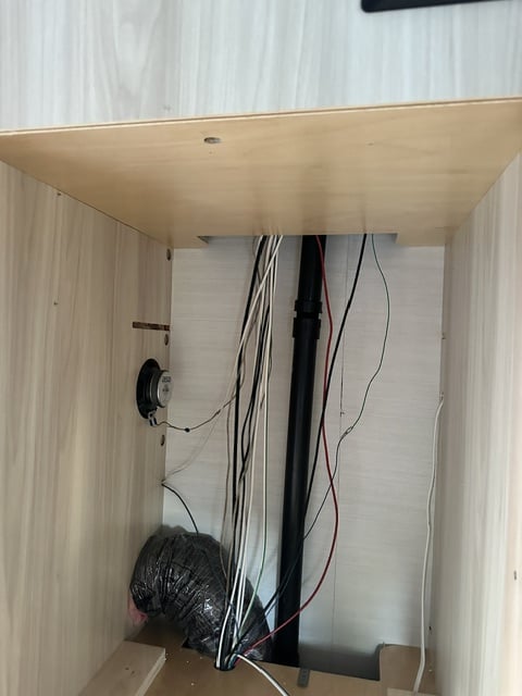

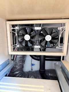

I pulled the drawer out and installed a thermostat controlled or manually controlled fan there. I made a frame and held the fan in place with parachute cord to hopefully reduce noise transfer to the cabinet. Fan link:

DId you cut a hole for the fan to discharge the hot air? I tried mounting two very small cooling fans inside the exhaust grill above the refrigerator. I wired them to come on whenever the fridge compressor energized. I was not happy with the volume of air they pushed and after a few days the bearings failed and they were so noisy I had to disconnect. I also added insulation to the walls around the fridge. The performance of this refrigerator is the worst thing about my trailer.

Thanks for your interest. I have not camped yet with the fan upgrade. I have only tested it at home.
I had this same fan in a previous camper, not a Tab, and it was quieter than the original refig cooling fan and did a great job.
As far as air flow, I have the fans puling air from the vents from the top of the open storage area that is under the pull out drawer. For the exhaust, I’m using the metal vent at the top of the frig. To increase the air flow I did cut out every other wood vent slot below the drawer. By holding my hand at the vent at the too of the frig, I can feel the air flow.
When I camp next, I will also test removing the drip pan from under the freezer while camping. I have several trips planned in July of 26. I’ll provide an update on the fan and if removing drip pan made any difference.1 -

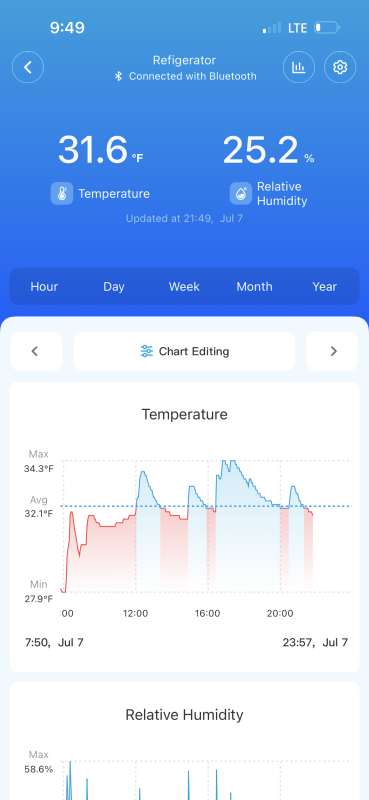

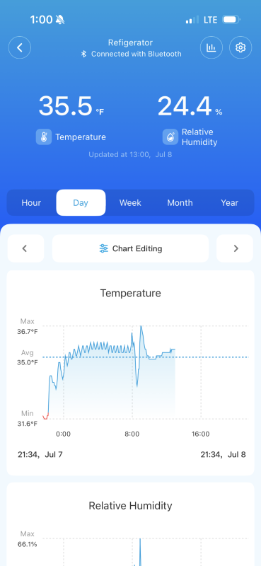

Here is un update on how the fan mounted behind the drawer under the frig is doing. I have a 24 Tab 400 Boondock with the Isotherm elect frig. I have a wifi thermometor in the frig. See photos for temperature ranges. I’m at 8600’, frig side of camper is facing west. I have electric. Air conditioning set to 75. Thermostat for ancillary fan is just above the frig on the bathroom side.
Day 2 of camping, 7/7/26. Fan set to come on at 85 degrees. Fan comes on late morning. If I set to 90 degrees, fan went off. Reset to 85. Frig set to 5 1/2. At noon sunny and 91 degrees. Sun just starting to hit the west side of camper. Removed tray from under freezer. Turned frig temperature to 5. At 4 PM fan turned itself off. Outside temp dropped 5 degrees and clouds rolled in. At 10PM set frig temp to 4.5 and re-installed tray under freezer. Turned ancillary fan off.
Day 3 of campinf. 7:8/26. At 8 AM opened rrig for breakfast. Turned frig to 5. Set ancillary fan to 85 degrees. Sunny and 88 degrees. At 1PM the fan was running. Set temperature to 90, fan turned off. Re-set back to 85 degrees.
I’m studying the screen shots of the temperature history now. Things are much better than my last trip. Hope this info, while detailed, made sense.

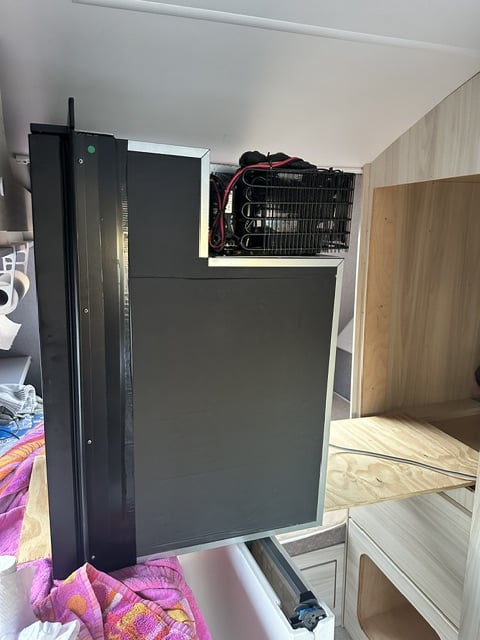

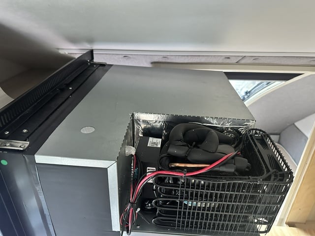

I've been wanting to get into the fridge cabinet to do a mod and seeing the pics in your original post @vttj gave me great clarity. I especially appreciate how you used plywood to make a platform to move/support the fridge outside of the cabinet. Thanks for that!

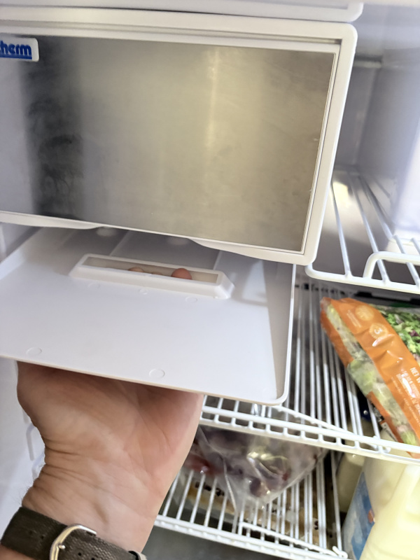

@B0atguy Please post pictures on how you remove the freezer tray!! Make it easier for the rest of us to do so! I want to do so for mine!😉
It is the plastic tray that catches water as you defrost the freezer that people are removing. Just place your hand under it. Frool for the finger slot. Pull/ slide forward.
Just slide out the tray under the freezer section as ssheets9 has shown in a picture . Very easy .
Just dont forget to put it back in as soon as you turn off the fridge or else you will have a wet fridge compartment as the freezer thaws !

@B0atguy Thank you for the picture! @Marceline I have saved that . I bought a simple bluetooth arrangement from Amazon so I don't have to open the door to see if it's cooling. If that should fail in the future will buy that one! How long do the batteries last?
