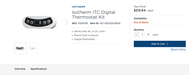

    Hmm are you aware of the intelligent Temperature control kit? I spotted it in fisheriesssupply.com . It's made for the Isotherm 130 refrigerator . Supposed to use a soft start feature on the refrigerator and has a Econ mode that is Supposed to drop power consumption by 40 percent.

    Hi thanks for sharing the info on the Isotherm ITC thermostat. I have come across that as well.
    From what I understand, it improves temperature regulation and helps balance energy draw, especially for those running on solar. In my case, I’m almost always on shore power, so power efficiency isn’t really the issue.
    The problem I’m seeing seems more related to heat buildup behind the fridge. When the sun hits that side of the camper, the temperature in the rear cavity gets quite high. At that point, the fridge is running continuously but still struggles to keep up with the temperature difference.
