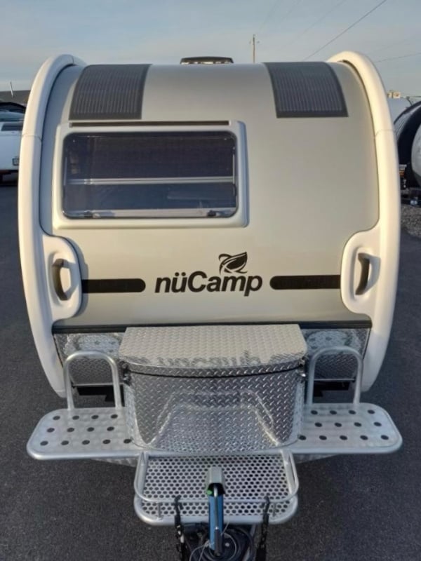

For those that are not familiar with the 2024+ 320-S Black Canyon, the model has the two 190W panels positioned on the left and right sides of the curved roof. The flexible panels stretch from the front just above the gally window over the curved roof to just above the bottom roof rack cross bar.

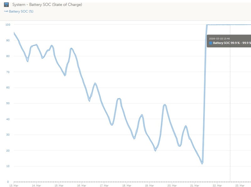

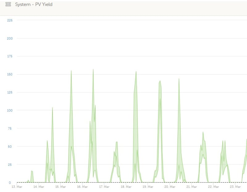

On a recent trip through the national parks of southern Utah, March 14th through the 21st, with consistent bright sunshine, no shade, >3000ft of elevation, maximum temperatures of 75 degrees, my Victron Cerbo GX recorded a single maximum solar yield of 157W. See the attached Solar yield and associated SOC graphs.
I'm concerned that these long 190W panels, curved over the roof, suffer too much partial shade during the day and as a result, yield less than half of their combined rated power.

From a theoretical perspective solar panel ratings are wildly optimistic as they are determined under very specific test conditions that do not reflect real world use. Typically the panels reach 75% to 80% of the rating in real world applications. So a 190W rated panel might put out ~150W. Add to that the variation in angle towards the sun which is I'm guessing 45+ degrees between both ends of the panel which reduces output plus solar panels get less efficient when they get hot. Maybe that all adds up to only ~160W.
Interestingly when I looked up pictures of 2026 Black Canyon models there are two different solar configurations, one with the dual long panels and one with individual panels in the front and back.

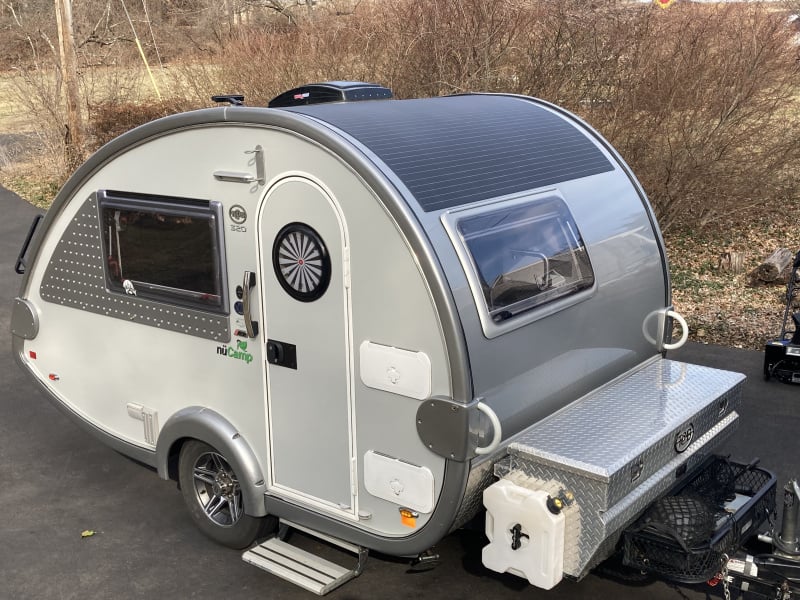

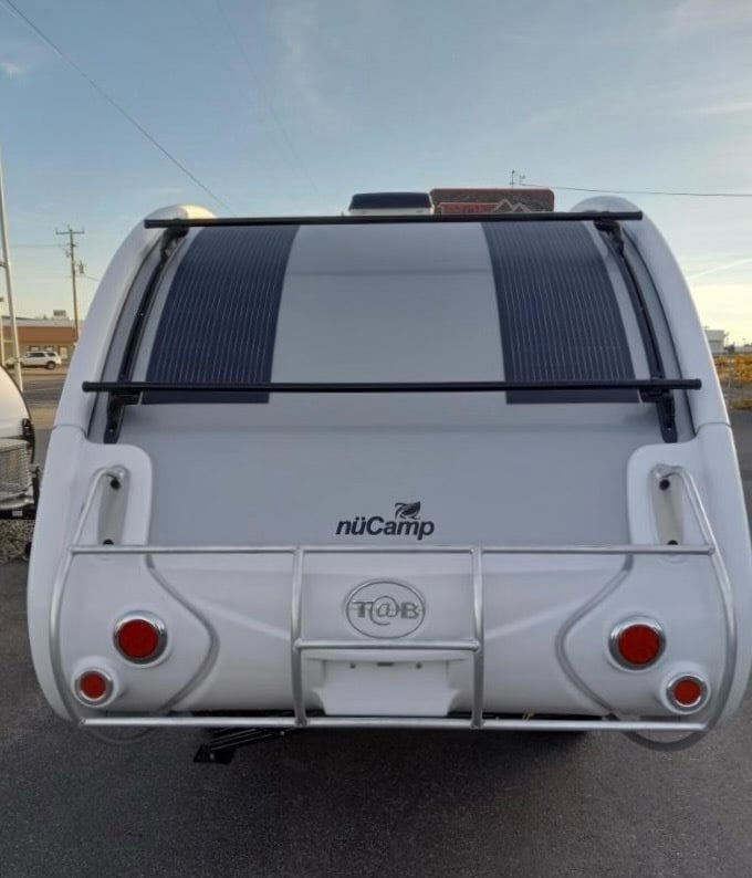

The 2024+ Tab 320-S Black Canyon is equipped with dual 190W panels as shown below. Note that the geometry has significant shadowing front to back during the course of the day.
@Trailpixie summed up the issue for his TAB 360 Black Canyon. The long series connected panels have too much shadowing. Given the 360's star gazing windows, his 4 panel solution with the forward slope panels in series, the rear slope panels in series and the two sets in parallel, would be a big improvement. See:
These long panels are part of a poor solar design that cannot keep up with the load of the DC frig and the fan, on low, even on sunny days.

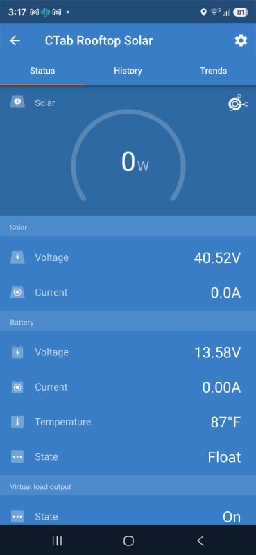

@SavvyNurseCamper, are your 400's two panels wired in parallel? If so then the front slope to back slope shadow loss would be reduced for morning and afternoon production while the 11 to 1pm production would be unchanged. If you get a chance, please measure the Open Circuit Voltage at your controller or check it in your Victron Connect app as that will give us a clue to the factory wiring configuration.
Note that my dual 190W panels report 40.52V which I suspect indicates a series connection.
If your panels are wired on series, that may be the reason that your production is insufficient for your refrigerator.

@bobctwin said, "The TAB 320-S available roof area may not support the 400's 310W panels. It would be great if it did."
It does …..Stockton, New Jersey
I suspected it would. Great picture! What is the wire loops for above the door?
@SavvyNurseCamper
We use a half umbrella above the door for sun / rain protection. I shortened the post so that it's a simple drop in place setup.Stockton, New Jersey

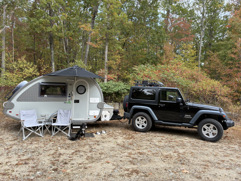

Not a bad idea, but no, we just have the one 310W panel. We tow with a two door Wrangler and have a dog. We use a rack on the back of our 320S for additional gear that won't fit in the tow vehicle.

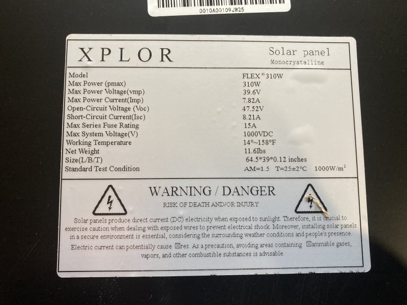

The open current voltage of the 310W panel is 47.52. I installed a separate 100/30 Victron solar controller to replace the 75/10 from the original rooftop panel.Stockton, New Jersey
I understand from your post that you replaced the factory installed 200W panel and 75/10 charge controller on your 320-S with this 310W and an upgraded 100/30 charge controller. This must have been a chore to remove the factory panel. Any wisdom on the process?
