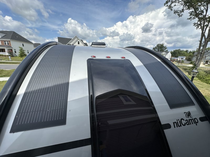

1) the configuration of long thin panels from front to back is cool looking, but not a good pattern for real life. The only time that the rear-facing panels get good exposure is either in the morning when the rear of the camper if faced east or in the evening when it is facing west. During morning and evening, the rooftop doesn't get good exposure. Good exposure on the roof starts around midday. At midday the rear portion of the panels are operating sub optimally and averaging the roof panels down.
2) The panels are wired in series. This can be good in optimal situations, but when a part of any panel is shaded, then all the panels behind them have their amperage reduced to the lower number of the shady area. This is somewhat offset by the increase in voltage of being in series, but there are some complexities that make this tradeoff problematic. If you had more individual panels wired in parallel or seres/parallel, this problem would be reduced.
3) The panels installed don't seem to have bypass diodes. The purpose of bypass diodes is to reduce the effect of shade on panels wired in series.  These would reduce the impact of everything above.
It would be much better to have the two long-thin panels made into four panels. There should be two wired in series on the roof and two on the rear wired separately in series. Those two series-pairs should be then wired to the controller in parallel.

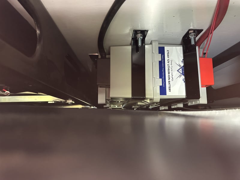

The battery is insanely inaccessible. In order to access it you will need to remove the entire belly pan. To remove the belly pan you will need to remove all four jacks AND the axle. YES. The belly pan is above the axle and the mounts for the jacks. Otherwise you could cut a hole in the plastic and then somehow close it back up.

    I have come to terms with the challenges of curved solar panels. My 2024 320S BBC has 2x190W panels on its curved roof. My 100W flat portable panel kicks it's @$$ on sunny days. The 2x190W have the edge over my 100W flat panel on cloudy days.
     Can't fight the curve. ;)

    I have 2 renogy flexible 175w panels on my 400. They go across the roof, not down. One on the front, one on back. In series. I have never seen 350w of production, but have seen close to 300 when driving with the sun overhead.
    The renogy panels have blocking diodes and definitely work when only one panel has sun. I also use a 100w portable panel sometimes. My goal is not to fully replenish the batteries every day, but to extend the time my 300ah of lifepo batteries run to meet my time at the campsite with maybe a day to spare without having to ration my use. Seems to work out. I think the key is having enough battery capacity.

    Like the 2025+ TAB 360 Black Canyon, the 2024+ Tab 320-S Black Canyon is equipped with dual 190W panels. Note that the geometry has significant shadowing front slope to back slope during the course of the day.
    @Trailpixie summed up the issue for his TAB 360 Black Canyon. The long series connected panels have too much shadowing. Given the 360's star gazing windows, his 4 panel solution with the forward slope panels in series, the rear slope panels in series (to result in a higher Open Circuit Voltage for improved MPPT efficiency) and the two sets in parallel (to remove front to back shadowing), would be a big improvement.
    A solution for the TAB 320-S would be two 200W panels, one on the front slope and one on the rear slope and wired in parallel.
    These long panels are part of a poor solar design that cannot keep up with the load of the DC frig and the fan on low even on sunny days as outlined in:

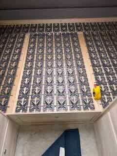

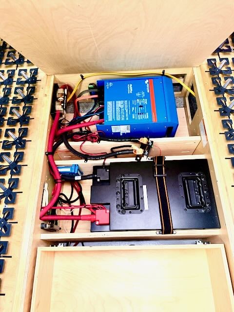

    I finally did it. I removed the two long, thin panels from my TAB 360 Black Canyon and have experienced greatly improved performance with 4 panels with bus bars and bypass diodes.
