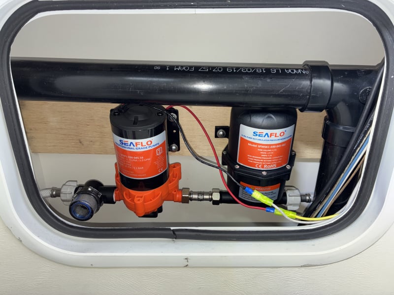

Following up on this topic, I installed the new system this morning. Beside the contortions involved, it was an easy project. It came with the pump and accumulator attached to a mounting plate, but the plate was too large to fit in the space so I removed them. I did keep them connected together by the short braided flexible hose. The pressure in the accumulator came set to about 10psi, so I charged it up to 33psi to conform to the 2psi below cut-in pressure recommended.
No leaks and it appears to be working properly. The pump is much quieter. When first opening a facet the pressure is good, but once the water is out of the accumulator it does pulse and makes some noise, but not nearly as bad as with the Shurflo pumps. I'd like to have more time testing, but we're heading out on a 6-8 week trip in about a week and a half. Fingers crossed.
For reference, the factory pump was a SHURFLO 4008-101-A65 that was replaced by a 4028-100-E54 and now a SEAFLO 33Stockton, New Jersey
