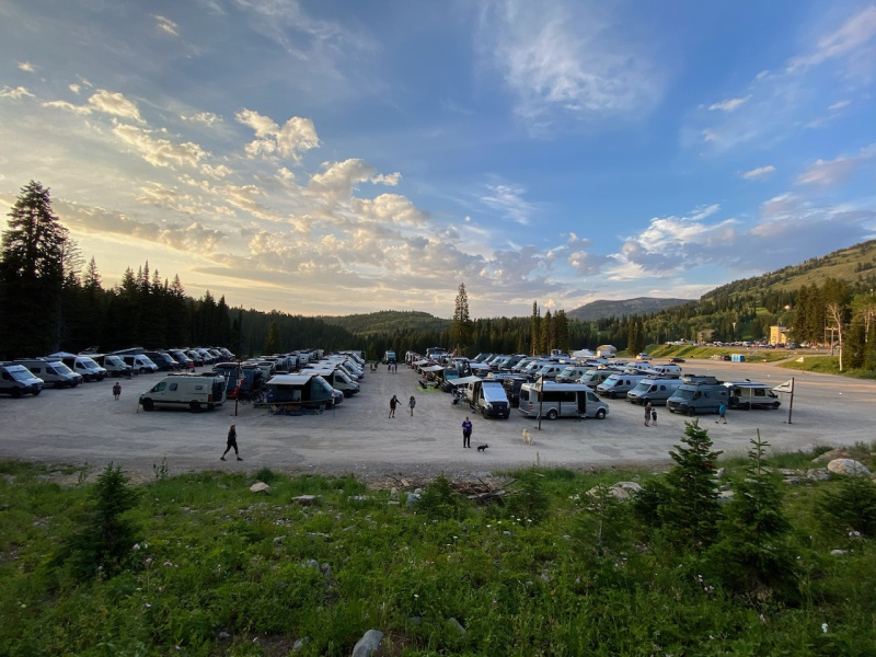

One barely related care-free anecdote, not relevant here I guess - but it was fun:
During back in 2020, we went to a Revel van rally and there was dozens of vans all in a big lot at the Grand Targhee in Idaho. We were up on a hill above the lot just looking around, and a gust of wind blew through the lot and simultaneously like 30 awnings retracted. :)
