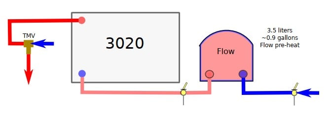

The Low Point HW Drain is after the TMV (hot-cold mixing valve),
The Yellow Pressure Relief Valve is directly connected to the Adle water tank.Using the Yellow Valve as documented in the Alde manual insures resetting the air cushion.

On my 2015 320, opening the low point COLD water drain will also drain the Alde. Cold water enters at the bottom of the boiler and HW exits at the top, so draining (regardless of the method) is typically through the CW feed.
Not sure if it will work the same on your 400, but might be worth looking into.

It depends on the installation. If the Alde is by itself, opening the cold water drain should drain the hot water tank. If there is an Alde Flow, this doesn't work. You need to use the yellow pressure relief valve.
Newer then 2023 may have a different design.

Thank you Mickerly. It is an Alde Flow so I guess I'll have to play by the rules.
