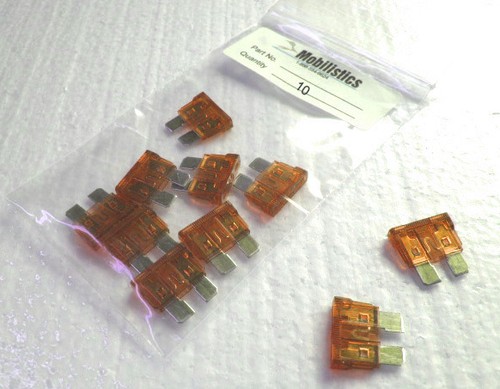

    Regarding fuses, does anyone know if it is absolutely essential to use a 40amp ATO (orange) fuse?   While I don't know a lot about fuses I've discovered that ATO fuses are open on the end and ATC fuses are closed.    It also seems that ATO fuses can be replaced with ATC fuses but ATC fuses cannot be replaced with ATO fuses.  If this is true, why not just use all ATC fuses since all the others are ATC?  Can anyone shed light on this?

    It's always nice when you find your own mistakes.    Contrary to my previous post here, the fuses that came with my 2014 T@B, at least those used in the power center, are all ATC fuses, including the 40amp (orange) fuse.   The previously mentioned fuse list provided by another forum user says the replacement fuse for the 40amp, should be an ATO fuse.   Now I am wondering why, since the original, at least in my T@B is an ATC fuse.   I'm particularly confused about this issue because I had previously learned that ATC fuses should never be replaced with an ATO fuse.   Can anyone shed light on this?

    Interesting comment from our dealer...they replaced our water pump and tweaked the piping so it's MUCH quieter. But the comment was about those elusive Alde fuses...3 brand new T@Bs just delivered...with bad fuses. So I gave him a couple of my spares and the Amazon link for more.

    Word back from the factory is that they were not aware of any dealer that had received several blown fuses on the Alde units and this was the first information received.  They also reported that Alde is very good with respect to supplying anything they need.  The factory has also contacted their purchaser and placed a request in to send 1 additional fuse per Alde system so that each unit produced goes out with a spare and Pleasant Valley would also have a supply available there as well.  Contact Ed Kauffman at the factory too (or Elsie Miller for parts) as Ed will have any additional details and information on fusing and the requirements therein.

    I found these fuses listed on EBay and know that they are also available on Amazon as well.

    Regarding the 40 Amp ATO and why my list says so:
    1) It was the one that came in the converter at delivery.
    2) There is a warning on the converter that states: REVERSE BATTERY PROTECTION FUSE 40 AMPS. REPLACE ONLY WITH LITTELFUSE BRAND #257
    Since I assume using something else "may" void the warranty, and a #257 is an ATO fuse, that's what I'd go with personally. #257 isn't produced anymore, replaced by #287.

    If you do an internet search for ATC fuses versus ATO fuses, you should find several references explaining that the difference is whether the backs have openings (ATO) that allow the fuses to be checked foe continuity with being removed, while the closed fuses (ATC) could offer some protection against contamination causing an "open" fuse to be bridged and fail to maintain protection.  One concern was expressed by a user of marine equipment concerned about salt water getting into the open fuse backs.  Personally, from my perspective and for my purposes, I will use either and not worry about the difference.
