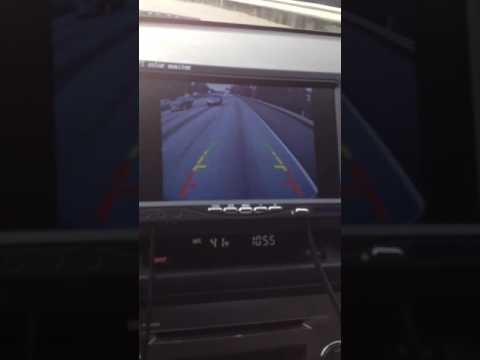

    Well after much advice, contemplation and testing, I've finished my rear view camera project to my satisfaction. I decided since the camper is always "hard wired" to my car when towing, I might as well hard wire the rear view camera to avoid any and all interference issues.
    Having decided upon hard wiring, I then came up with a fantastic idea - to utilize the already built in coax cable to bring the signal to the front of the trailer! There must be over 10' of coax cable that had always been just laying around under my bench seat.
    So I bought a $5 adaptor from coax to RCA (the video output of rear camera), screwed in the coax, routed the coax under the seats, then bought another adapter for the car end of the video receiver. I now have a very rugged outdoor coax running from the trainer, along the frame, into the trunk.
    The video quality when driving is absolutely astonishing and perfect! I can see way way way behind me and both lanes to my right and left. It's exactly what I wanted.
    So if I had to do it over again, I'd get the same monitor, same cameras, and skip the wireless TX and RX and just use the coax.
    The above is while driving, you can see the T@B rear bumper in the extreme right and left hand corners. Massive view!

    I wish I could figure out how to post the video I took today that shows the highway performance. I suppose I could post it to youtube if folks want to see it. I've uploaded the video to Facebook.
