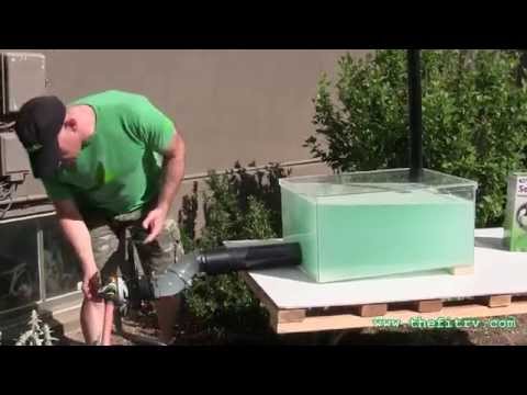

    Here's an interesting analysis of some reverse flush systems:
    https://m.youtube.com/watch?v=dfTd0Slt_cU

    I saw those, but they only really do one round and they don't use any enzymes.

    I have seen the video too. What is compelling is the fact that using the hose fitted devices never realy flush beyond a bend in the pipe. So far my process has been to dump black, fill via toilet with a few gallons flush again(repeat until clear) put another gallon or two with enzyme..drive home. So far, so good...ready to go on next trip.
