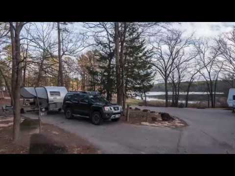

Ratkity, I don't know where you are located, but I'm pretty sure I'll be jealous of your temps when summer comes.
It was not really "by the lake." We just stayed at the Lakeview site. The water front side was full.
Video from this weekend camping/hiking:
https://www.youtube.com/watch?v=_PkdPzSTNHw
