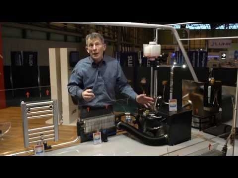

Indeed, the Alde is a radiant system. It works by heating an electric element or propane burner located on the drivers side under the bed. This heats glycol that is pumped throughout the system through radiators (convectors) located strategically around the trailer. The heat rises through vents located next to the walls: under the table, next to the bed, by the kitchen window, and on the shower wall. There's no fans, no forced air, just quiet even heat. To confirm that it is heating the glycol, after it has been running for a half hour or more, go into the back of the closet and feel inside the little window on the front of the Alde reservoir to confirm that it is heating the glycol.
Here are a couple of short videos that give some insight. Be aware though that not everything in these videos is applicable to the installation in the 400. Our heated floor feature is only in the bathroom. The less than 1 amp draw applies to running the pump when the unit is on propane (it's an energy hog on 110), and we're not aware of a smartphone app at this time.
