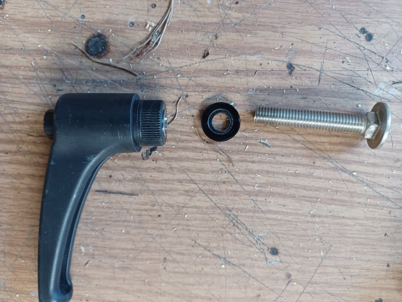

    How many folks have "overtightened" the handle and found it so seized you could not back it off with tools, had to saw through the bolt and replace handle, as I am doing?
    It must not be uncommon!

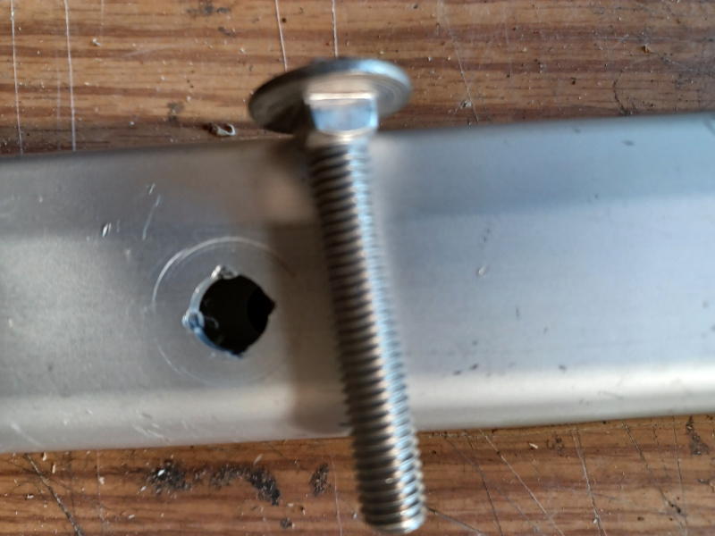

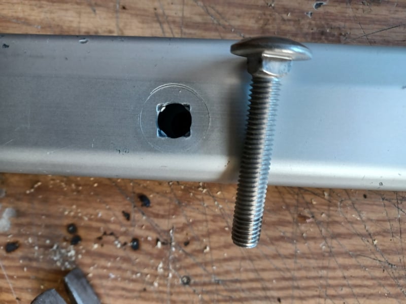

    I purchased and returned 'normal' M8x1.25 thread carriage bolts and have to buy this expensive part instead..  The carriage bolts Lagun uses have a much larger square boss under the head than appears normal.  The square recess in the aluminum arm is creatively but poorly 'machined' by Lagun by drilling four holes rather than using a broaching tool.  For some this will lead to stripping out the bolt head.
    All in all this is a disappointing product.  The threads appear to have galled and cannot be backed off.  The force needed instead spins the brass threaded insert around which the plastic handle is molded.
    That's a new to me failure issue.
