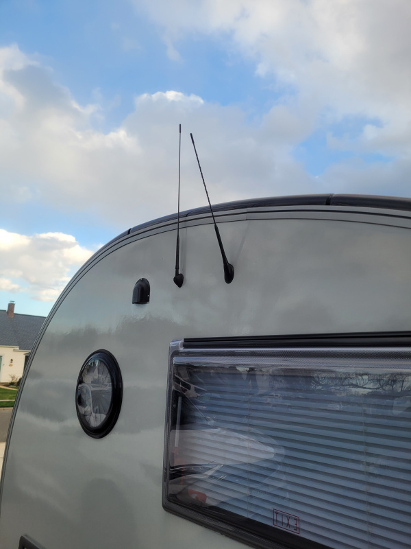

I see its been a few years since this post was made. I recently purchased myself a 2021 320S and as a ham radio operator I did some investigating for a permanent antenna to get over the air tv. I had some adapters and decided to add a 2nd AM/FM car stereo antenna and hook it to the TV using some adapters. Its not as great as a larger antenna, but works for traveling with no setup other than scanning for local channels. i removed the microwave and placed it about 10 inches away form the original. I am about 30 miles east of New York city and with a normal house antenna on the roof I get about 68 channels, with this I get about 42 and good signals.
