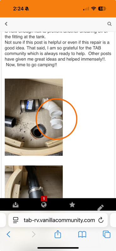

    Currently doing this very same repair.  The broken threads came out nicely with the tool.  (thank you!!).  I understand the how and why of your vertical pipe cut with the rubber connector/hose clamps.  After viewing your shower drain repair, wondering why you did not use the same flex hose for the 90 degree turn to the tank with the sink connection repair?  Or maybe 90 degree rubber (see below).  Looking to put the flex closer to the tank joint.  Thoughts, reaction or ideas?  Thanks!!
    Maybe something like this
    Update:
    Went with inline rubber because the 90 degree piece stood too tall after attaching to the threaded insert.  Pictures below of the final install.  We will see if there is now enough flex to prevent another shearing off of the fitting at the tank.
    Not sure if this post is helpful or even if this repair is a good idea. That said, I am so grateful for the TAB community which is always ready to help.  Other posts have given me great ideas and helped immensely!!.  Now, time to go camping!!

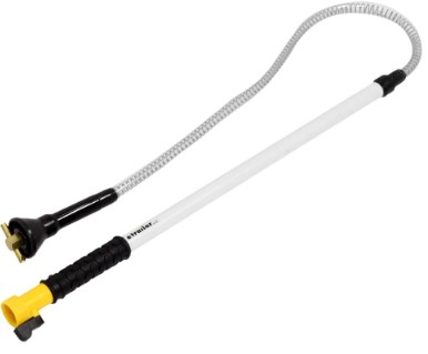

    1. What tool are your referring to, to get the broken thread out. Couldn't find it. Is it something like an Internal pipe nipple extractor (ChatGPT told me that). What size did you use?
    2. I can see what you used as a connector between the pipe and the white 90, but what size (height) is the 90 and the thread attachment?

    How did you fix the 90 to the tank adapter? I don’t see a thread. Did you glue it?
    2020 T@B400 BDL w/solar | 2022 Ford Expedition
  • OinfrontOinfront Member Posts: 46
    @anba I took a screenshot from @NorthernDale post
    I think you’re referring to the circled adapter. You will need to glue it. Use a primer and glue for either pvc or abs piping depending on which you use. The white piping is pvc and the black is abs and then there is a special glue to bond pvc to abs as well. Or you can use the rubber coupler like in the photo.

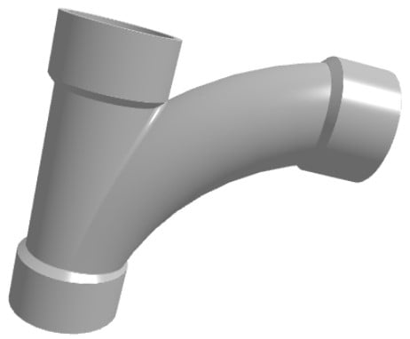

    The elbo used was also a wye:
    Use the elbo part to replace the section as noted above, but then cut a relief in the cabinet bottom, add a short extension to the vertical wye to extend into the cabinet and add a removable cap.  If that could be done I could then run in my flexible rinse and clear out grey tank!
