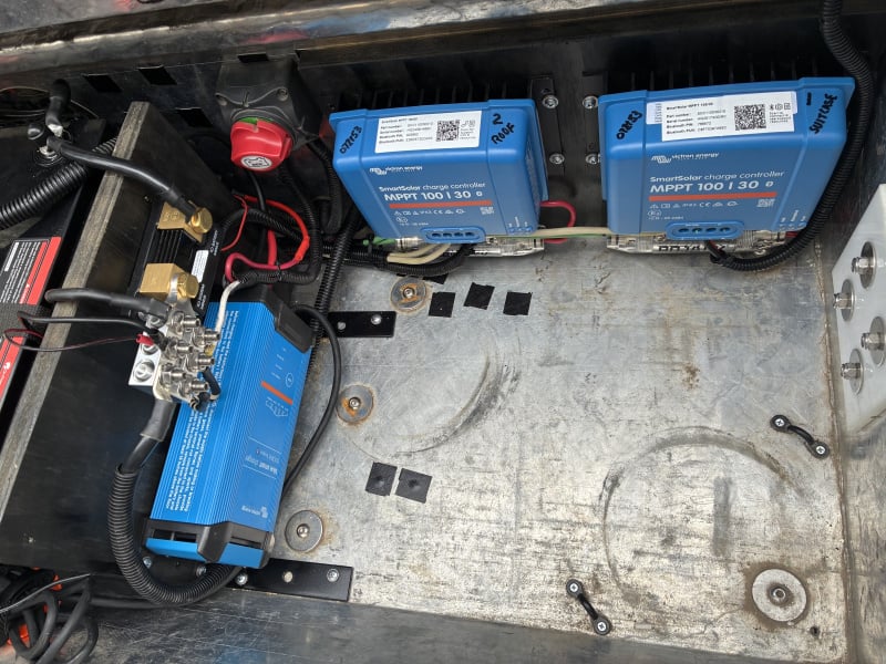

    So I made the modification in my post above (except the DC-DC converter) to test with my Lead Acid battery before purchasing the Lithium battery.  My WFCO power converter had a full size 20A breaker for circuit 5 so I replaced it with a dual 15/20A breaker and used the new 15A circuit for the Victron Blue Smart charger and the AC power to the SPDT relay (amazon - https://a.co/d/a8oCiC6).  By simply turning off the 15A breaker the converter will work as wired prior to the modification.
    When I first connected the trailer to shore power, I verified the relay was connecting the Blue Smart charger to the battery and the trailer's DC circuits were being supplied DC power by the converter.  I did not initially enable ve.networking and measured the voltage at the battery as 13.6 volts with both a voltmeter and the SmartShunt.  The Blue Smart charger showed an output voltage of 14.2 volts in the Victron app, thus confirming the voltage drop of the 10 AWG wiring.  Current was about 16A.  I then enabled ve.networking and the app showed the Blue Smart charger increased the output voltage to 15.07 volts, 17.2 A and 14.35 volts at the battery.  I confirmed this with the voltmeter on the battery as well.
    This means you can upgrade to Lithium, leave the battery in the tub and use the existing 10 AWG power wiring as the Blue Smart charger will compensate for the voltage drop.  Now I need to order my Lithium battery.
    Below are a few pictures of the installation and screen shots from the Victron app.

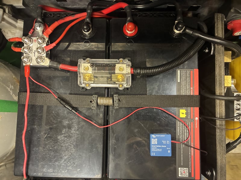

  • AnOldUR
    AnOldUR Member Posts: 1,731
    edited March 13
    Not as nice or clean of an install as many of you have done, but it works.
