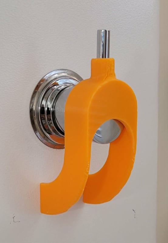

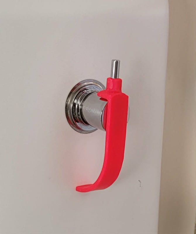

    A simple and effective fix for the shower spraying you unexpectedly is this little 3d printed shower lock.
