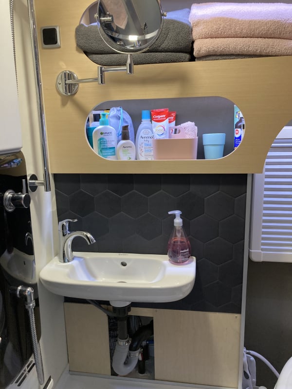

For multiple reasons, I've never been a fan of the sink assembly. Over the years I'd collected a lot of valuable information from others that have done this modification. 4 years later, I finally did my own and want to pay it forward.
  I chose poplar because it's beautiful, technically a hardwood and it's light. I got the boards from Menards. 1/2", 1/4" and 1" for the countertop. We have milled poplar from trees we had to fell, but I'm really sick of plaining boards. So I took the easy way out on this project.
I built a rudimentary frame to help disperse the weight of the sink and countertop. Put rubber pads on the feet, in hopes it would provide some cushion.
I kept the lower portion of the original sink assembly. I did this to save on materials, utilize the large access panel and because I thought it would look nice.
This cutout was intended for storage, but mid project I changed my mind on the design. I'd hoped to put the faucet in the left, upper corner. However, there just wasn't going to be enough clearance once the fittings were installed. I cut a large enough opening at the bottom and the face plate is removable. If I need to repair or replace water lines, I can. The shower curtain will be covering most if not all of this when I use the shower. Just in case, I put small rubber weather stripping behind the face plate to help keep water out.
I purchased a 10' length of water line, making sure that it was rated to be under pressure. Then used PEX rings for the NPT fittings.
The drain was the biggest challenge, since there was very little room to work with. I didn't want to use any corrugated hose, so I built one using braided silicone hose, 1" barb connectors, Fernco, and worm clamps. It's not pretty, but it works.
As we all know, there's a lot of vibration during travel. I put a large bead of kitchen and bath silicone on the rim of the bowl. Then set the sink. This way there is a larger point of contact and not just the drain assembly holding it in place. The white skirt is vinyl stick on baseboard. I found the white plastic screw caps on Amazon. While they stick out visually, I felt it would give the new design something in common with the old.
  I do have some concerns with how the new sink will hold up with travel over time. But I loved it so much, that I was willing to take that chance.

    Beautiful work! I like that you thought to add some bit of insulation to the wall while it was all apart.
    The plumbing bit in a cramped space led me to just ditch the whole sink assembly in favor of more hanging towel rods.

    @qhumberd thank you. Yes, it is cramped for sure! I have used the bathroom sink often, however. So I very much wanted to keep it. I've had a few years to come up with some kind of solution. Thanks to what I'd learned here.

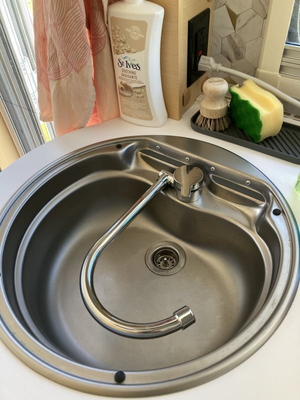

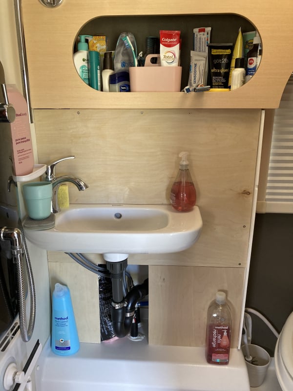

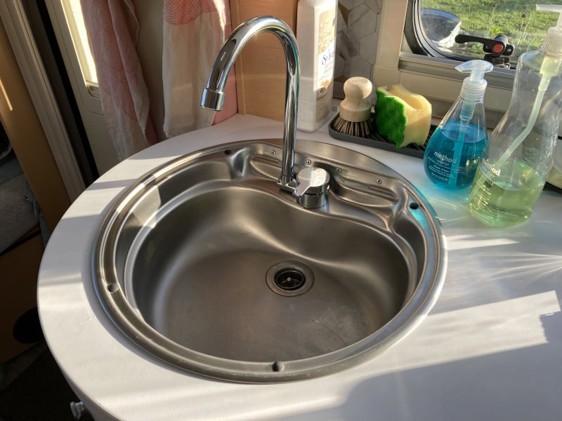

    I’m finished most of my kitchen and bathroom mods now thanks to all the great advice and suggestions I found on the forum. This spring I want to change out the shower faucet and tap. I have soaked myself so many times by hitting that little “stick”. Why does it point up? It’s like a hook just begging to be caught. I included pics of the new sink faucet too. I absolutely love all the changes. I hated that fold down sink. It was impossible to clean properly. I still have to finish the under the bathroom sink, as you can see.

    Beware of your kitchen faucet. I did the same change, but over time, the neck gets loose that lets water leak around the faucet area. There is a small plastic cover to take off to get access to a screw to tighten it back up. However, it simply gets loose again (as you raise/lower the neck). I finally took it completely apart and put some Locktite on the screw to hold it in position. I'm about to go on a one month trip, so hopefully it holds this time.
