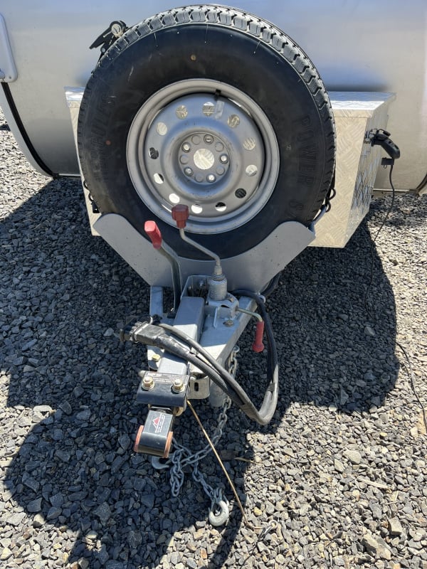

Below is a photo of our T@B on the Rimrocker Trail.  When we're not traveling in the T@B, we're in our renovated 1948 Spartan Manor.  We just returned from 6 weeks going to Mexico and back to see the total eclipse in Durango Mexico.  I've added a photo of that too.  Thanks again for all the great info in the forum.

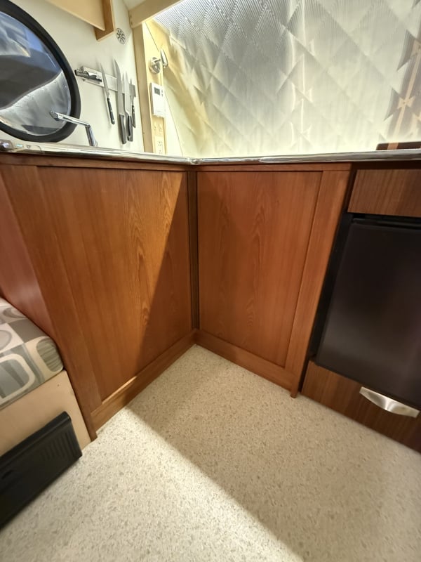

    Here's the new galley.  We took out the tall cabinet and the A/C unit and made it an L shaped kitchen with larger sink and drain board, new larger stove with cutting board cover, more counter space, toilet and bank of drawers behind sliding tambour doors from repurposed teak credenza, new larger fridge, built in 10 gallon water tank plus space for a 3 gallon Dometic jug with pump dispenser for drinking water, opening in counter for trash, new electrical to include LED indirect lighting and task light, new quilted stainless steel backsplash, new laminate top with metal edge.

  • RomanaRomana Member Posts: 52
    Very nice indeed! What brand fridge is that, I’m looking to ditch the Dometic.
    Well, we ditched the Norcold that was in ours for a Dometic.  It's newer, more efficient and larger.  We got the Dometic CRX Pro 65.

    We also moved the spare to the tongue, replaced the storage box, and changed to a Max Coupler off road hitch. Inside the new box are two 100ah LiFePO4 Battle Born batteries, a DC/DC charger for a direct connection from the tow vehicle, and an inverter to run our Starlink. There's a battery disconnect switch, outside connections for 12v and portable solar panel and a smart shunt to monitor everything.
