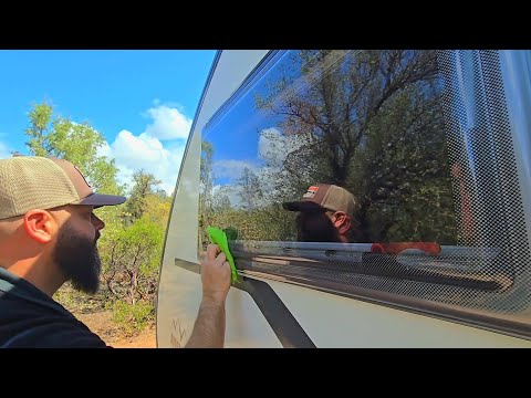

DSW recently did a nice video on cleaning the windows and some of the products he mention act as protectants. not totally helpful for you regarding restoration, but I, too, use a cover and am going to look to some of these products to provide a little more protection (and look for some kind of covers I can use when the bigger cover is on them.2024 T@b 400 BD "Tabba the Hut"
