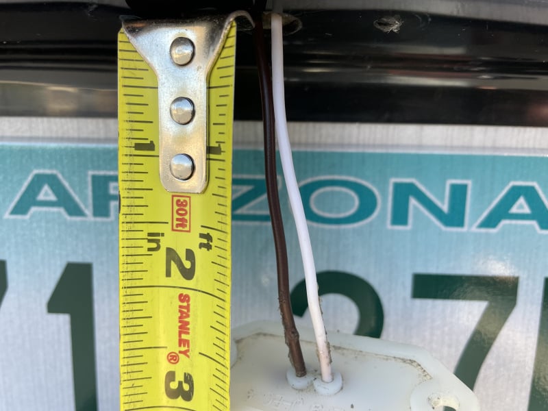

    @Bayliss thank you for researching this. The 2014 Tab’s rear  lights are on the diamond plate below the hatch cover. I did locate a white and a brown wire that run along the side wall that disappear under the metal cap that is screwed into the base of the hatch. I’m thinking that removing that cap may provide access to the wiring for the lights. See photos below.

    @xslsand, it is possible those are your tail/running lamp wires (brown - positive; white - negative), but I have also seen nuCamp use green for those lights, so take that into consideration.  They are green on my trailer, but it is a 2019 T@B 320 S Boondock Lite.  If you look at the diagram of my electrical junction box (J-Box), which is located at the front exterior frame of the trailer (see post regarding the "J_Box") here: https://tab-rv.vanillacommunity.com/discussion/6406/electrical-resources#latest , you will see that the wire is green.  BUT, brown has also been used for the tail/running lights in some RV electrical applications.  If your J-Box is similarly configured, temporarily disconnecting the wire for the tail/running lights will tell you if that color wire is in fact controlling those lights.
    BEFORE disconnecting the wire from the applicable terminal in the J-Box, be sure there is no 12V battery power going to the J-Box so you don't risk getting shocked, or blowing a fuse.  Once the wire is detached, re-connect the battery power to determine if power to those lights has been lost.
    If the metal cap depicted in your photos is easy to remove, that will likely resolve whether the brown wire you found is in fact connected to the taillights.  If, for some reason, that does not expose the electrical connection, you could access the back side of one of the tail lights to determine what color wire is present.  However,  it might be more helpful (and more reassuring) to contact nuCamp directly and ask them how to access those wires for your model year trailer to add a license plate lamp, and ask if what you want to accomplish is doable.  They would be in a better position to help you out with this issue.
    nuCamp does not always respond immediately (in my experience), so give them a few days for a response before re-contacting them.

    AND, for what its worth, the wire colors for my license plate light (as wired by nuCamp) are brown and white:
