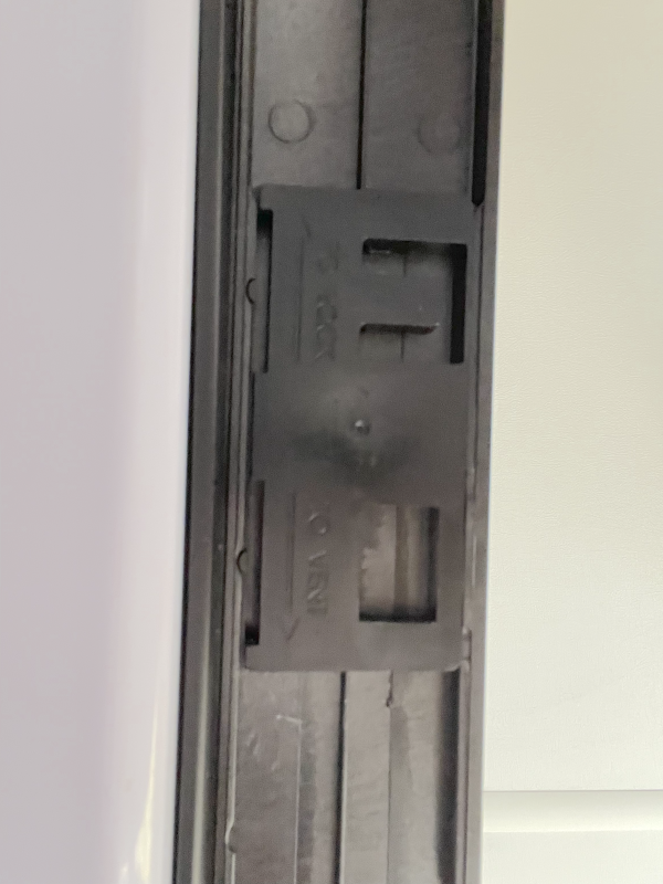

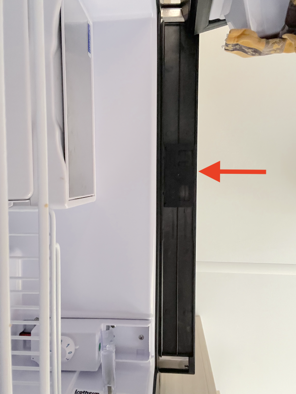

    I have never had that issue with the fridge in my 2024 400.  Even in hot weather.  Do you accidentally have the fridge in the “vent” position rather than the “locked” position?  If it is in vent then it would not cool properly.

  • Bill&SuzeBill&Suze Member Posts: 169
    @Jautotte, a good suggestion was made above by @XenanMe regarding the refrigerator door latch position. I was unaware of the two options until someone on the forum pointed them out, and perhaps you are also unaware. It takes a bit of upside down head turning to see the sliding latch plate at the top of the door opening. The "vent" position allows the door to stay partly open after shutting it. The "lock" option keeps the door fully closed and sealed. My report above reflects having kept the latch in the "lock" position. During earlier trips when we inadvertently had the latch in the "vent" position, we were dismayed at how warm the temperature stayed in the refrigerator. The difference is quite noticeable. I also commented above that we now remove the freezer condensation tray while traveling and replace it after returning home. Now the refrigerator performs well once we became aware of these two features.
     (As a side note, we found that the door on our refrigerator stayed firmly closed while traveling when the latch was in the "vent" position but could be forced open by contents inside when the latch was in the "lock" position, so I added a stop pin at the top of the door that we insert while traveling and remove at camp.)
