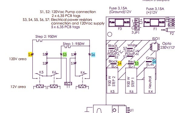

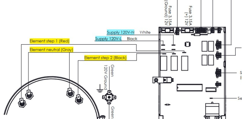

    @MuttonChops @Tabaz     Referring to my 2015 320 Boondock T@B.   Last night I decided to do a second check and confirm that I am not getting heat from the Alde while on electrical.  I am plugged in to my garage 120v. Fuses look good and circuit breakers are in ON position.  I've double checked that my  power cord plug is seated and that I have power there.  I have the old style termostat. I turned the electrical on. up to one click, I left the propane off, I turned the heat and hot water on (not the hot water only setting) and finally turned the thermostat all the way up.  I could hear the Alde (not the converter) turn on and I could hear the glycol tinkle.  I left it on for 1.5 hours.  Upon going into the Tab at that point I couldn't feel any heat from the Alde.  I checked the output from the back radiator area to be sure.  I did not touch the radiator itself.  I know it takes awhile to heat from electrical, but I think there should be some heat by then. The outside temperature was 72 degrees. This morning I double checked the valve positions to make sure that they were in the right alignment.  I think they are correct.  The hot water valve and cold water valve are open. (In line with the water lines.) The Yellow bypass valve is closed (down, not up). Both hot and cold water valves are closed.     The confusing thing is that I hear the Alde and I can hear the glycol tinkle. I appreciate Tabaz's instructions for how to clean the thermostat's contacts, but I'm leaving that for a last ditch effort as it seems the most invasive. If the contacts were not working, would the Alde turn on and would I hear the glycol tinkle?  Thanks- Parlando
  • MuttonChopsMuttonChops Member Posts: 1,916
    My 2¢ . . .
    Since the Alde boiler runs on propane & the circulation pump actives to heat the cabin but neither happens on 120VAC it sounds like the Analog Control Panel thermostat function if fine.  There is an issue with the 120VAC.
    The Adle is a 12VDC unit.  The only thing the 120VAC does is power the two electric resistive heat coils.
    So possible causes are:
    1)  No 120VAC, check the Alde compartment output . . . with a meter of 120V fan/light/etc
    2)  Analog Panel is not sending the 'turn-on' signal . . . not sure how to troubleshoot at this time.
    3)  The Alde Control PCB 120VAC Relay(s) have failed.
          Might be possible to hear or feel the relays activate (two person job).
          If they, all three, activate then Analog Panel and relays are good.
    4)  Heat level Step 1 electrical coil has failed.
         Might be possible to try increasing Analog Panel to Heat level Step 2.
         If only coil 1 is bad, coil 2 would begin heating and not trip your house shore power 15/20A circuit.
         You can also use an Ohm meter to check the electrical coil resistance.
         One owner has reported the coils are in the 14 - 16 Ohms range (no idea if that is accurate)
          See This Alde Thread
    Note: These two diagrams from the same source document have different
    Wire Color to Terminal mapping.
