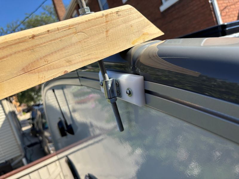

Just a quick note that might help people attempting a repair like that in the video. I have a 2021 320S and, again, my trim is just starting to get loose in a couple of places. I am currently securing the loose areas with thick, double-sided tape and epoxy glue for plastic and metal. I had a problem getting the trim to stay seated in the keder rail while the glue set. So I made a quick, crude clamp out of some hardware store odds and ends (I already had the bracket that I made for my tv antenna). Hopefully the idea might help someone out there.

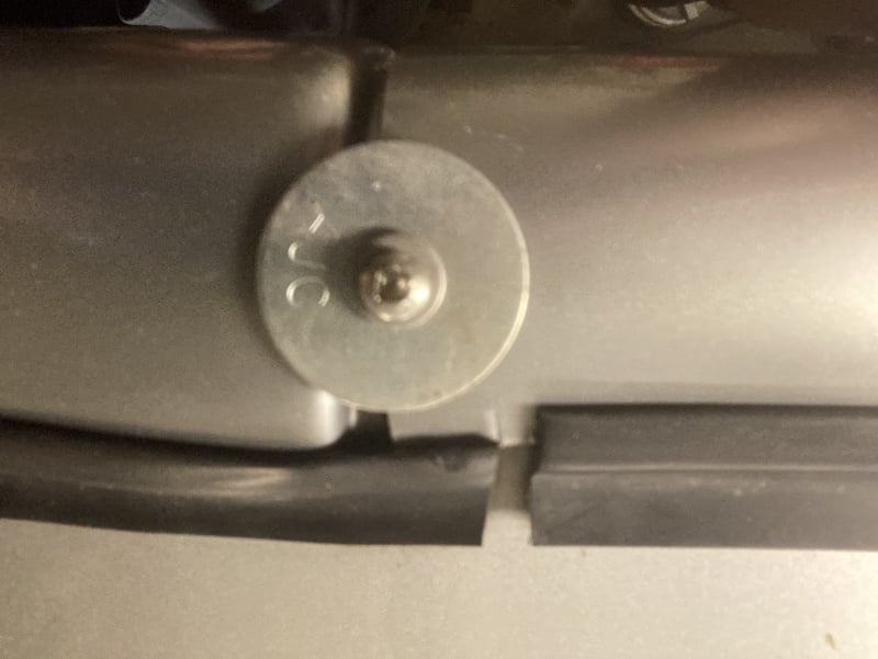

I've posted this before, but it has worked well for our 2020 320S ...
(longer screw and stainless steel fender washer)
@AnOldUR. That's a good idea. My problem was that both sides of the joint were slightly loose and 'springing' upward. I don't think there is anything to 'screw into' in that orientation...at least not on the 2021.1
