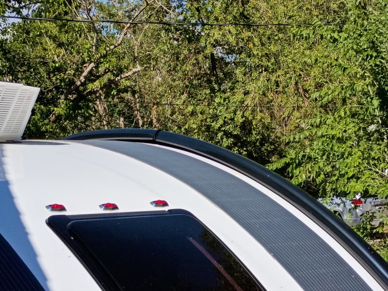

I've seen photos of people losing their trim / Keder rail on the highway. I thought I saw something about some clips or something that can be used to prevent this from happening. I've attached a photo of the rail on my T@b 360 which appears to be rising up at the top. Can anyone tell me about the clips?
I just reviewed a couple of threads about the rail falling off - and repairing older rails that had cracked, fallen off, etc. It sounds like I should just wait until it happens and deal with it then. Fingers crossed I'll be lucky and it will stay in place.
No, do not wait. If you are on the road, grab some strong tape and secure the trim to the edge of the trailer. Try to keep air from digging under the trim and having it fly away. This is a newer design of the "trim" compared to years past (this type of trim is probably about 3 years old?).Review this video, which I think might be what you are thinking about.

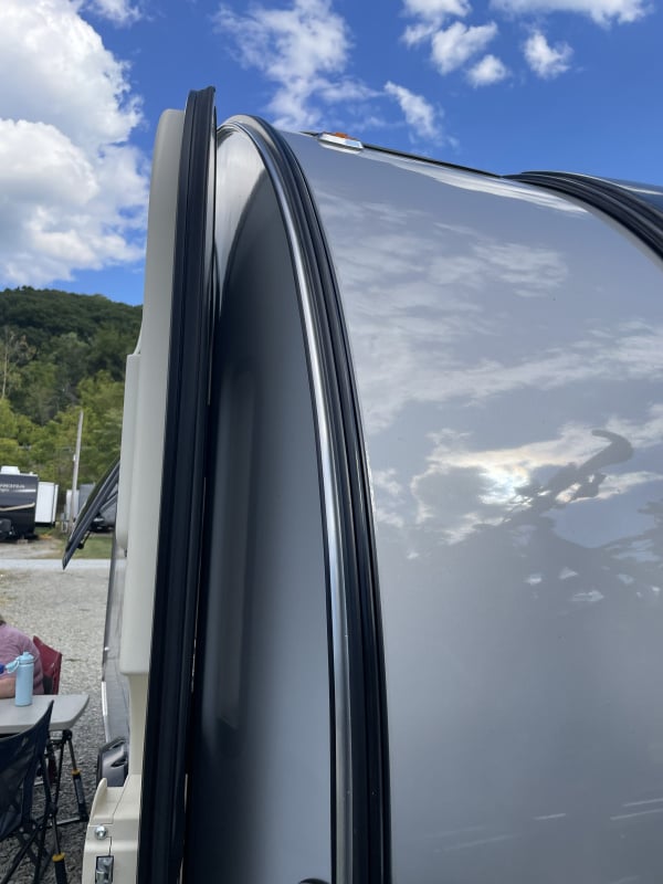

Interesting video. My 2021 clips haven't rotted out yet but this identical joint appears elevated.

Just a quick note that might help people attempting a repair like that in the video. I have a 2021 320S and, again, my trim is just starting to get loose in a couple of places. I am currently securing the loose areas with thick, double-sided tape and epoxy glue for plastic and metal. I had a problem getting the trim to stay seated in the keder rail while the glue set. So I made a quick, crude clamp out of some hardware store odds and ends (I already had the bracket that I made for my tv antenna). Hopefully the idea might help someone out there.

@AnOldUR. That's a good idea. My problem was that both sides of the joint were slightly loose and 'springing' upward. I don't think there is anything to 'screw into' in that orientation...at least not on the 2021.1
