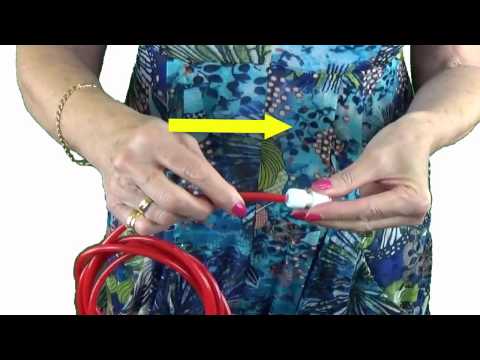

    That is the mixing valve for the plumbing.  Which exact spot is it leaking from?  From the "red" pipe connector where it connects to the mixing valve?
    These are "John Guest" push fittings.  You push them in slightly, and when you let go, they release from the side of the valve.  It might be that your push fitting has worked loose a little bit.
    This thread has a discussion of a failed valve, and it shows how the fittings come out and what they look like.  It may be that just "resetting" the connector properly will stop the leak.
    If you can, look closely at the inside of the brass pipe coming out of the valve.  There is a small screen in the valves that can become clogged, so see if you can get a look inside.

    @Dana I agree with @pthomas745 and there is a short video that demonstrates how to remove and reseat the fittings i pulling from another thread:
    https://youtu.be/799KOuSOxrQ?si=tY6NEct3_CGds36G
    Good luck

    thanks for info everybody.  I did try pushing in the John Guest fitting (thanks for the name) but it came loose again.  Next step is to try to take it apart from the brass fitting and putting it back together again.  Check inside brass as well.  My issue is a leak at that spot not a mixing problem (although now I know where that is) Fingers crossed that will work!  Try to get around to it in the next few days.  Will let you all know.

    Thanks, ScottG.  Problem fixed!  I pulled the hot water pipe from the John Guest push fitting (just like in the picture from Disenchanted).  Couldn't get the fitting out of brass pipe so I didn't get to see or clean the screen in there, but jiggled it around and put back together.  Voila! Success.
