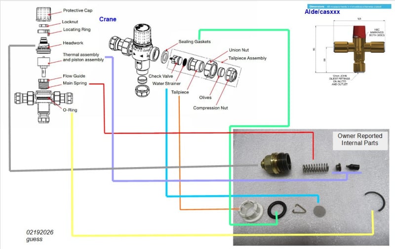

Diagram is from the LK 550 AquaMix mixing valve literature (attached).
The LK 550 was noted by at least one forum member has the make/model used in their system.

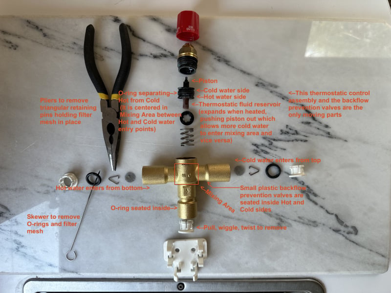

Update: I took my TMV out of the trailer - the John Guest Push Fit connectors are actually pretty easy to undo - press the black elbow and white collet into the TMV, hold the collet against the brass and pull the fitting (elbow) out. Worked for all three joints.
Took the valve apart on my workbench. Found a crushed o-ring, and the hot water check valve seemed stuck so i removed the screen and exercised it several times... and put it all back together... It now works like it is supposed to, but the water temp never goes above lukewarm, but it stays at lukewarm with the pump running!! i could live with that, but wife likes hotter water so going to buy and install a new valve since it is so easy to install. A couple pics below... Oddly, my best support came from an Airstream dealer - Airstreams have Alde units too. My Nucamp dealer was useless, had no parts in stock, and advised it was very hard to order parts from Nucamp. The Airstream dealer placed the order for the new TMV while i was on the phone. If you are ever in a pinch it is useful to know that airstreams have alde units and parts too.
Unit disconnected at the John Guest Push Fittings:
Parts (disassemble with 3/4 inch wrench) top row is from main body, lower row is from the hot side connector (collet with sharkbite teeth, o-ring, screen retainer, screen) Also pictured is the crushed o-ring
Reassembled valve with new o-ring
2 -
Excellent! Looks like you have found the 'root cause'.Disenchanted said:
. . . Took the valve apart on my workbench. Found a crushed o-ring, and the hot water check valve seemed stuck so i removed the screen and exercised it several times...
Now, is your mixing valve an LK 550 ? - - - pictures look like a different brand/model then used in earlier build-year Tabs - - -
Not the first time someone has made that observation. Which is interesting since nearly all nüCamp units have the Adle while Airstream currently only has One Model of their large selection that uses the Adle.Disenchanted said:

Thanks, I did not know 'the name' for those things.Disenchanted said:
. . . the John Guest Push Fit connectors are actually pretty easy to undo - press the black elbow and white collet into the TMV, hold the collet against the brass and pull the fitting (elbow) out. Worked for all three joints.

@MuttonChops - disenchanted has a 2021 400 with the newer style mixing valve that replaced the LK 550 valves in our older rigs.

It is very odd to have three actual failures of the TMV in such a short time frame. My guess is you have a scaling issue that is jamming the internal moving parts. It is possible to disassemble, clean, lubricate and reassemble to "fix" an issue without replacing the full TMV.
Current best guess is ADLE is rebranding a {cheap} Cash Acme HG110-HX TMV. Cash Acme datasheets do not include exploded diagrams nor do they appear to sell "rebuild kits". Also, no TAB Owner has posted a detailed diagram on the disassemble process for the Adle TMV (there is one for the older LK550).
All that said:
[1] This video has a very helpful disassemble and internal parts discussion on a typical TMV.
It is similar to the Adle TMV
[2} Using another brand TMV exploded diagram I've attempted to map the Adle TMV internal parts (TAB owner sourced).
This might be helpful.
