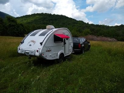

I think the big thing is to measure your intended roof area mounting location and shop the wattage you want by panel size. Manufacturers make different sizes of the same wattage panel. Other specs vary too, but size seems to be your biggest issue if you're looking for 400W on the back. Here is a pic of two 100W panels on a 2018 T@B 320 in the location you're talking about. You can see they overlap the Yakima tracks. To be most effective the racks were removed during use. They were enough to keep up with the 3-way fridge demand in 12V mode while driving with only a modest drain on battery. I believe they were HQST brand (shipped from same warehouse as Renogy products). They were selected because they were the shortest length 100W panel that could be found at the time. The top area of the roof where these are mounted was almost a perfect angle.

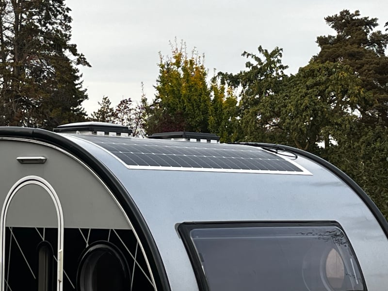

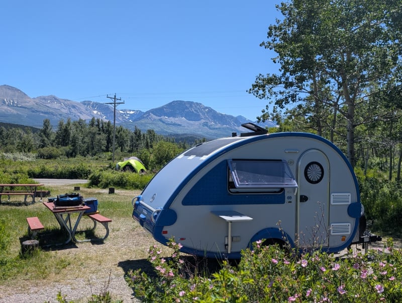

I put a 200W panel on my 2017 T@B 320s earlier this year, but I don't have a rack. The bottom edge of my solar panel (not counting the pieces of tape) in the picture is 43 inches from the line of trim between the rear handles if that helps you. I don't think that it would be possible to change the orientation and fit a 200W panel to each side of the roof vent (maybe there are longer/narrower flexible panels). 2 100W panels could be arranged that way. The panel could probably be mounted another couple of inches higher, but I wanted to avoid possible shading from the roof vent. The panel is a BougeRV Arch 200W Fiberglass Flexible Solar Panel and there was no problem getting it to follow the curve of the roof. This setup easily replenished the depletion from a day or two of camping (2 100AH LifePO4 batteries, but I'm not using an inverter for heavier battery draws) on a relatively sunny day while camping or driving down the road. The panel is connected to a Victron 100V/30A charge controller. That would allow me to integrate an additional panel on the front of the roof, but right now I don't think I need it.

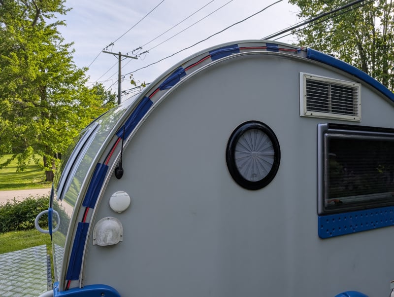

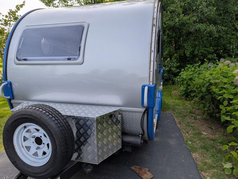

For my install, I ran the cables from the solar panel to the drivers side of the roof and then placed them under the trim to run them to the front of the trailer. The cables emerged from under the trim below the trim covering the front driver's-side handle. I then routed them to the back of the tongue box, where I have the batteries. The exposed wires in the picture were placed inside a piece of electrical loom and then covered with Eternabond Roof Seal Tape.

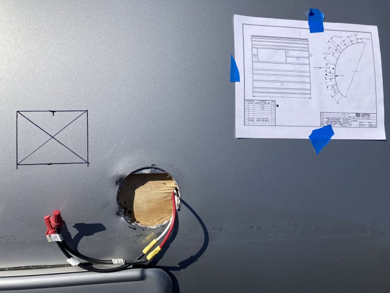

@Alan57 Our 2020 320S came with a smaller panel on the front so wiring was in place. The junction box on the new panel was in a different location, so another hole in the roof was necessary, but there was enough slack in the wire to reach the new location.
That said, the location of the junction box is behind the cabinet above the sink. I only had to cut through the outer aluminum skin to connect to the existing wiring, but it would not have been difficult to also go through the inner panel and route the wires hidden inside the cabinet and drop down behind the wall in the bath.
Here's a picture of where the original hole was located and the marked out location for the new one.

Our wires were run in the same fashion as @FishDoctor, except down the passenger side (no advantage, just how my mind worked at the time). The only other difference is I continued the wires all the way under the trailer, beneath the trim and then through a loom to the tub. On the side of the tub, I had installed a port where we could attach our two 100W briefcase panels. The rooftop and ground panels met at a busbar before going into the Victron MPPT controller. I had mounted the controller on a panel that I installed in the back of the tub. The panel themselves were attached using 3M's VHB tape on the top and sides. I left the bottom open so any potential moisture could drain out. The exposed cables on the roof were held in place with cable ties on cable tie mounts. To strengthen the bond of the mounts I used Eternabond patches with a small cutout to allow the cable tie to attach.

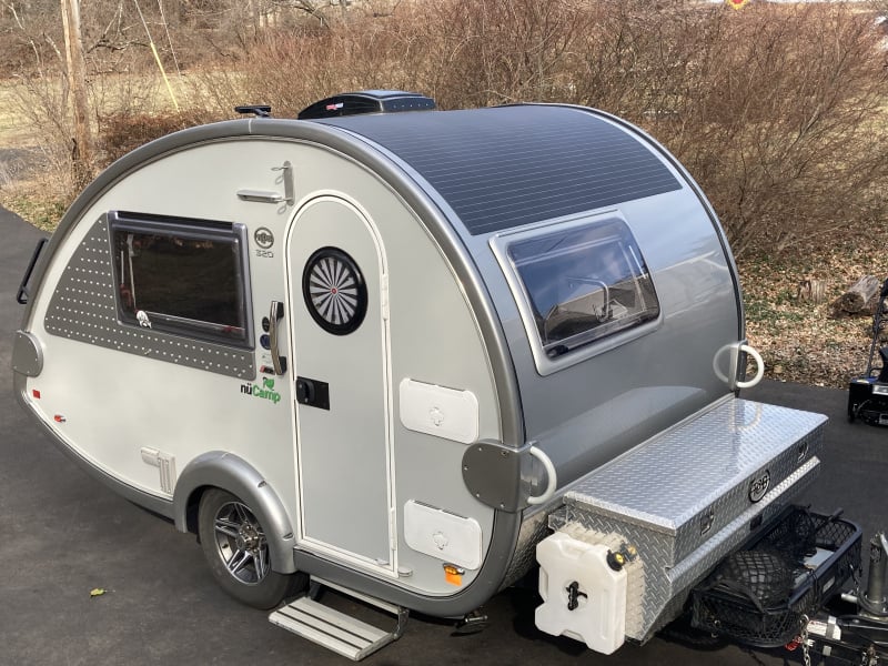

To avoid any interference with the Yakima roof rack on the back of your 320, you can put a 310W panel in front of the roof vent.
AnOldUR: in the small-world department, my brother teaches at Stockton University! What brand of solar panel is the 310W in your photo?
2017 T@B S Max, Blue and Silver -- "The Blueb@rry"
The panel is a Sunflare XPLOR. It's the one the nuCamp uses on some 400's. I bought it from nuCamp through our local dealer, Miller Trailer Sales. Miller no longer sells nuCamp, but still does a great job at service.
Stockton is actually not the location of Stockton University. It's a small river town about 20 miles north of Trenton.
