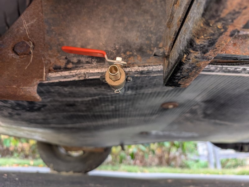

2017 T@B S. Valve handle broke off the freshwater drain, so I want to replace the valve. Can someone tell me what size PEX is used for the drain line so I can get the right fitting?

FYI in case anyone else needs to know. I cut off the existing crimp holding on the old fitting and compared it to 1/2 inch PEX fittings I had on hand. The sizes matched (at least visually). I replaced the old valve with a quarter-turn 1/2 in. Brass PEX-B Ball Valve. It was crimped with a 1/2" stainless steel PEX crimp on the back barb and the pipe behind the valve was anchored to the frame with a 1/2 inch plastic pipe clamp screwed into the same holes used by the original anchor clamp (which was cracked) with Anderson (square) screws. When I installed everything, I made sure the valve opened by pulling the handle toward the stairs and the swing to shut it off and turn it on weren't blocked by any obstructions. Not a difficult repair except for the limited space for working and cutting off the old and crimping on the new crimp ring. I think this style of valve will be easier to manipulate.

Great idea! Those little valves can be difficult to reach and turn.Sharon / 2017 T@B CSS / 2015 Toyota Sienna Minivan / Westlake, Ohio2
FishDoctor Awesome mod. Think I'll give it a shot on my T@B.
