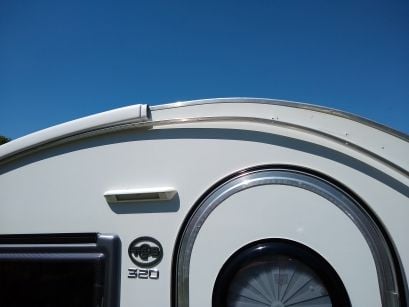

Decided I will run wires under the trim. How is this removed on a 2017 320? Any sealant or glue needed?

This 320 has been gone with its owner for a long time... had to look way back to find this picture. 1. Remove enough screws from the keder rail to access the screws on the front section of the trim (if you still have the plastic insert in your keder rail, pull it out first). 2. Remove the screws from the trim. 3. Lift the trim off of the camper. There is no glue or sealant needed for this piece as the trim is mostly aesthetic. If you take the cover trim off of the front handles there is some sealant you may need to replace when reattaching the screws (can't remember what type NuCamp recommends, but someone will surely add that info if they read this and see it missing).
