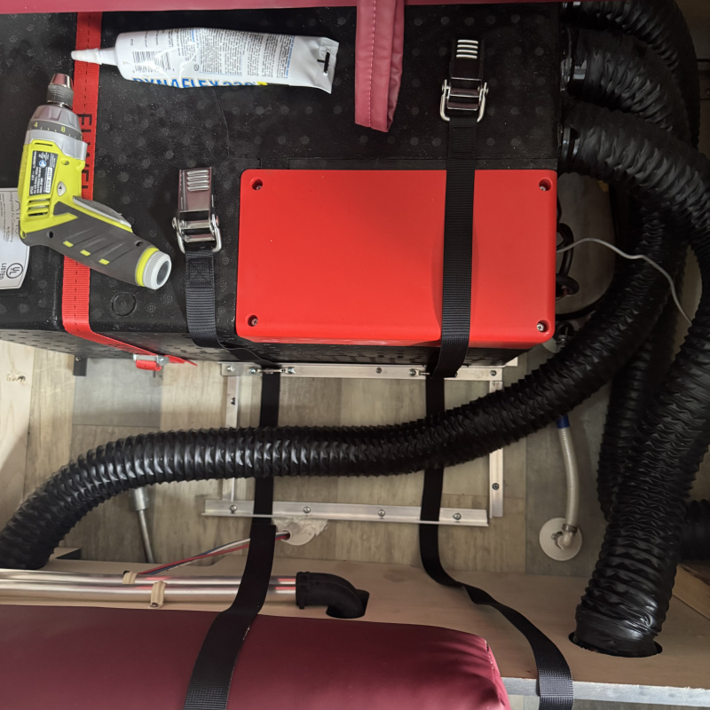

Here are the photos of my Renogy Core Mini 300Ah battery installed next to the AC unit:
I had to cut part of the gland to get the battery in. I used the "bigger the glob, the better the job" approach to sealing the gland. I don't know what the red, white and blue wires that go into the gland are for. I mounted two 1" strap loops to the existing metal frame for the AC unit and put angle aluminum around the base of the battery. Two Monster Lithium battery straps hold the battery in place, but I think one would have been sufficient.
I also took about 4 feet of wire off the AC power cord for the AC unit. Not sure why NuCamp left it so long. It's enough of a mess without additional wire length.
I plan to mount a Victron 75/15 MPPT controller just forward of the negative battery terminal on the back of the rear bench. I will probably mount the bus bars in there as well if I can make them fit, otherwise they will be placed in the left wheel-well. I will likely leave the existing Victron 75/10 MPPT controller where it is now in the left wheel-well.   I am also adding a 300A Victron Smart Shunt with temperature sensor.

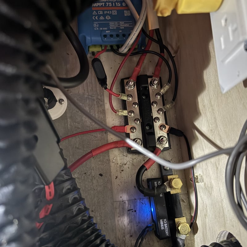

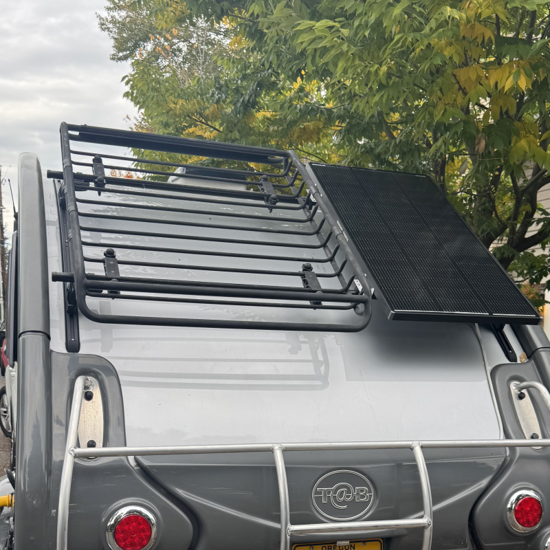

    Thanks everybody! I have successfully installed a 300Ah LiFePo4 battery in the passenger-side rear compartment in my 2022 320S Boondock, just forward of the AC unit. I left the battery disconnect switch in the front tub. I also installed a Renogy ShadowFlux 120W solar panel on the rear rack and an associated second Victron MPPT 75/15 charge controller and Victron 300A Smart Shunt. The Renogy 120W panel was only $93 delivered.
    I fished the wire from the solar panel through the back cowling and ran it up an existing gland from underneath that had red, white and blue wires associated with the fresh water tank level sensor running through it. I repurposed existing screws to hold cable clamps to secure the cable underneath the trailer.
    The new MPPT controller, terminal block and shut were mounted between the AC unit and the center divider (left to right).
    For whatever reason, the original MPPT controller ran directly to the batteries in the front tub. I repurposed these two wires in parallel to bring the new battery to the front tub. This eliminated having to find a way to fish wire from the rear to the front tub.
    I ran a cable from the Nautilus box to the battery for a Nuco Genius charger. That should make the storage place happy.

    Knowing what I know now, I probably should have mounted a 200W panel and removed the rack. I sized the wiring from the panel to the new MPPT and the new MPPT itself to handle a 200W panel so that would be a relatively easy thing to do. Alternatively, I may buy a solar suitcase and run another plug to the battery. There is space on the new terminal block for that.

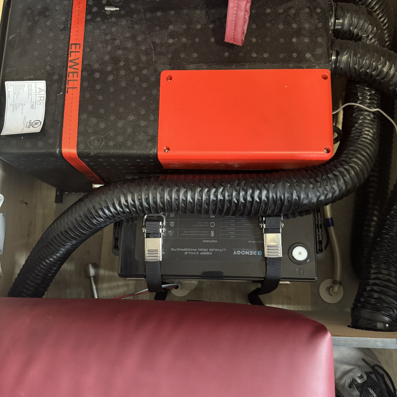

    I'd love to see a picture of your 300Ah LiFePO4 battery installed by the Air8, also if you can provide the make and model? My 2024 320S BBC came with a 100Ah Battle Born battery, I was able to fit a second one in the same compartment. I didn't think I could fit a bigger battery anywhere, but if possible I'd love to see a pic. Here is mine:
  • CatDaddy
    CatDaddy Member Posts: 130
    I'd love to see a picture of your 300Ah LiFePO4 battery installed by the Air8, also if you can provide the make and model? My 2024 320S BBC came with a 100Ah Battle Born battery, I was able to fit a second one and the same compartment. I didn't think I could fit a bigger battery anywhere, but if possible I'd love to see a pic. Here is mine:
    I installed a Renogy Core Mini 300Ah LiFePo battery. It is not self heated but it has temperature protection. Having it inside the cabin should moderate the temperature range it experiences.
    Here are a two photos. The first one shows the metal frame I made. The second photo shows the battery installed. The new MPPT controller, smart shunt and terminal block are mounted to the right of the AC unit in this photo. I used two Monster Lithium battery straps but one would have sufficed. Note that I had to hack the gland containing red, white and blue wires to get the metal frame to lie flat. The battery is very secure. It isn’t going anywhere. Let me know if you have any questions.

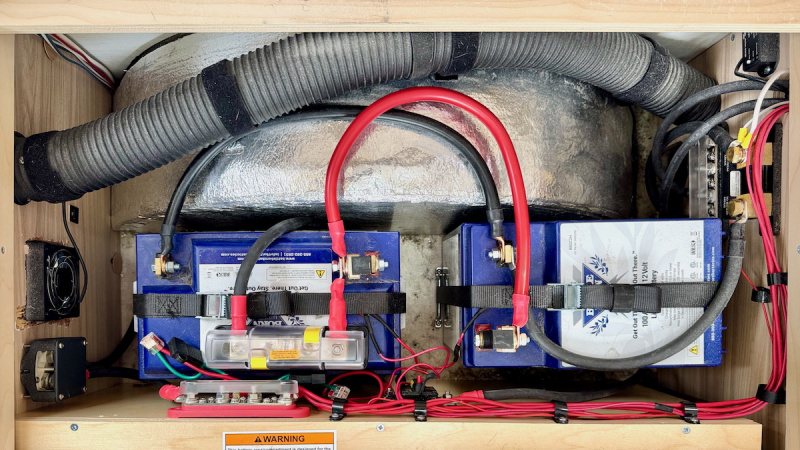

    Ask more questions....the below diagram may or may not make it more confusing.

    #1; Yes, You only have to move  the + Battery wire from the solar controller to your (new) busbar or to battery inside (with fuse).  You can leave the -(neg) battery.  There is no other change to the solar controller .  Your is mounted inside under the driver side bed...correct?
    Yes it's under the bed next to the shower.
    #2.  There is a negative busbar behind the WFCO with all the other component grounds.  You can connect it there.  It maybe full.  You can add another small ground bar.  Just run a wire inside from the battery negative to this bus bar.
    Got it.
    #3.  Not sure which circuit you are refering to, but probably yes, here was my complete install if that helps.  Has more "stuff" but might be helpful.
    On your simpler diagram, you had the new inside battery connected to a busbar, then to the cutoff switch, then to the converter. There was no 30 Amp fuse, but it sounds like I need to put one in that row.

    I used a Blue Sea Systems PN 2722 DualBus Plus busbar.  As the name implies, it has both positive and negative busses. It has 1/4" studs at each end of both busses and five #10 screws for other connections. It is rated for up to 150A. This saves space and it has a plastic cover to keep stuff from dropping onto the terminals and a ridge between the two busses to prevent shorts. As of this writing it is on sale for $24.
    I connected a Renogy Core Mini 300Ah battery to one end of the busses and the system to the other with the 1/4" studs. The two MPPT controllers and the external charging port to the #10 screws. The negative terminal of the battery connects to the negative bus bar via a 300A Victron Smart Shunt to monitor the battery. See photo below. I used #6 marine wire to connect the battery to the busbar and #8 marine duplex wire to connect the other end of the busbar to the rest of the system. I needed #8 because I plan to add more solar panels.
    I highly recommend using marine wire instead of wire intended for AC wiring (THN, THHN, etc) because has finer strands and is more flexible. I used marine duplex wire (red and black in one jacket) made by Ankor.
    I bought the battery from Renogy on a Black Friday sale for about $750 including shipping. Most of the other pieces of my system including the Victron Smart Shunt, MPPT controller, temperature sensor, wire, lugs, fuses and so on from West Marine. They have brick and mortar stores as well as online stores. I bought most of the parts online and returned anything I didn't need to the local brick and mortar store.
    I highly recommend buying a quality, expensive, crimp tool. Loose crimps are dangerous. I found several loose crimps in my trailer. Apparently, NuCamp doesn't have a quality crimper.
    Don't forget to put a fuse or other protection device in series with the positive terminal of the battery. My battery has over-current protection, but I don't want to rely on it. I fused my system at 40A but the wiring is good for 50A.
    If you put in a Smart Shunt, I recommend buying and installing the temperature sensor that goes with it. It connects to the Smart Shunt (blue terminals on the right-side of the photo) and the positive terminal of the battery. This allows you to set temperature limits and monitor the battery temperature remotely.
