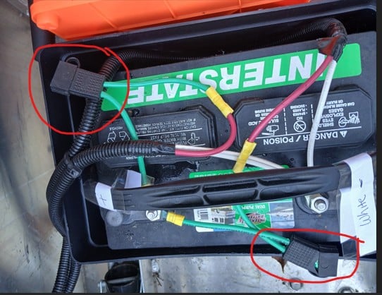

I believe the circled fuses are the inline fuses attached to the battery cables. So, these would need to be upgraded to handle the Lithium 100 amp LFP upgrade?
You don’t want to change the fuses without changing the wire. One of the green fuses would be your solar. How many wires are coming off the + side of the battery? It looks like just the 2 but hard to see.2021 T@B 400 BD
2025 Toyota Tundra / Nashville, TN1 -
If you’re not planning on adding an inverter to the system you should be fine not changing the wiring as you have not introduced any new loads. The new battery will be able to source much more current than you need and this is fine as your system will not need it. Is the converter charger in your camper able to charge lithium?2021 T@B 400 BD

On your battery wiring, there are two sets of cables. One set is for the battery power to the trailer, and the other set goes to the solar port on the side of the tub. Both the positive cables are equipped with 30 amp fuses.Many owners have installed lithium batteries in the 320's with no changes to the fuses at the battery or the fuses inside the converter.In the trailers with the larger battery banks, inverters, etc, there are larger "battery protection" circuit breakers, but these setups are usually twice the size/amp hour rating of your 100 amp hour battery. Many 320 owners installed multiple batteries (lead acid or lithium) and made no fuse changes.
