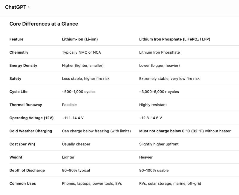

You may be confusing Lithium Phosphate and Lithium-Ion. We use LiFePO4's in our T@B's which are very safe. On the other hand, even AGM batteries can off gas under the right (wrong) situation. About the only justification for AGM is continuous extreme cold conditions, but even then a heated LiFePO4 might be a better alternative.
They recommend not charging your batteries in a wooden box including LiFePro.2021 T@B Boondock 400. 2021 Toyota SR5 V60
RayJim said:They recommend not charging your batteries in a wooden box including LiFePro.This engineer is curious: which “they” says this?LiFePO4 chemistry has none of the “thermal runaway” characteristics of lithium ion batteries; the latter are the type which can burn up and are nearly impossible to extinguishI’ve never seen a manufacturer, seller, or internet “influencer” of LFP batteries recommend against using them in enclosed spaces.I have seen people be confused in thinking that LFP have the overheating risks that Li-ion batteries do.

@RayJim Thanks for the link and Happy Holidays! I am glad to see what other countries are doing about RV batteries and lithium in particular. I was not aware that there was a requirement for enclosure and for venting. Hoping someone with more knowledge can explain this further, as all the information I have read indicates that gas venting is not required. Not sure of the reasons. And I discarded my enclosed box in my 400 when I switched to the LiTime battery.
That article is focused on lithium ion batteries, not LiFePO4 batteries that typically go in trailers. Those requirements, including venting, are appropriate for lithium ion batteries.Rich2019 T@b 400
2025 Toyota Highlander 2.4L TurboBellingham WA2 -
There are numerous battery chemistries that use lithium and technically all of them are lithium ion batteries. In the US "lithium ion" typically refers to lithium cobalt oxide batteries which are the ones that have spectacular thermal runaways. Poking around Australian websites it appears they generally refer to lithium iron phosphate batteries simply as lithium ion. It's fair to assume the article refers to LiFePo batteries because that is what is typically used in RVs. I'd also assume that whoever wrote the government regulations has no clue about the specifics of the batteries and just did a copy/paste/edit of what was used for lead-acid batteries.
