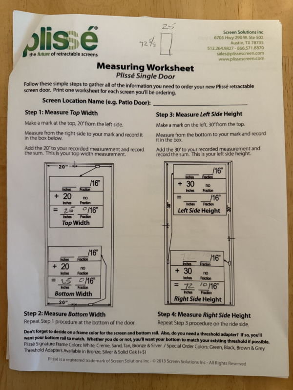

    @HighPlainsDrifter  @raveykeeg @Marceline @AnOldUR @NoMITravelers… I recently replaced the original screen in my 2018 T@b400. The original stringing began to fail a couple of summers ago and finally failed completely last summer. I inquired about ordering a replacement from NuCamp through several dealers. At the time (fall of 2025), the screen was available from the factory for a little over $300. However, shipping to California was going to be more than the screen, around $350.
    A company called Plisse Screen (Plissescreen.com) provided a very similar to original retractable screen door for approximately $325 INCLUDING SHIPPING to CA.
    The quality of the screen door seems to be better than the door that came as original equipment. They can make the door to your precise measurements. You do need to do some assembly of the door frame, but this was quite easy and took me no more than 20 minutes. You do not have to do anything with the stringing of the screen.  Obviously you then have to install it in the trailer.
    The door fit perfectly and looks great!  Highest recommendation from me!

    @scott14  No, I did not order the one for the Scamp.  They have an order sheet, which allows you to call out the exact specifications for the door you need. I’ve attached the one I sent them which would probably (?) work for you since you have a 2019. With all the changes they’ve made to the front of the trailer and the dinette area. I wouldn’t trust that this would work for any of the newer 400s. It’s pretty simple to get the correct measurements for the order form.
    As I said, in my previous post, I’m extremely happy with my new screen.

    @gande, thank you for providing this information!
