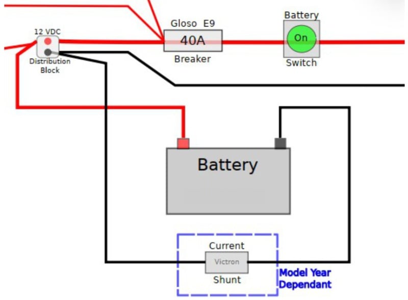

In general on TAB 400 with a factory installed Shunt:
- 1 - There is one large wire from the battery negative terminal.
- 2 - That wire leads directly to the shunt,
- 3 - The other side of the shunt is wired to the Negative Side of a 12VDC Distribution block
{ a two terminal small item with several Positive and Negative connections. }

Thanks for the diagram @MuttonChops. I’ll try to trace the leads from the battery and find the shunt.2024 T@B 400 Boondock0

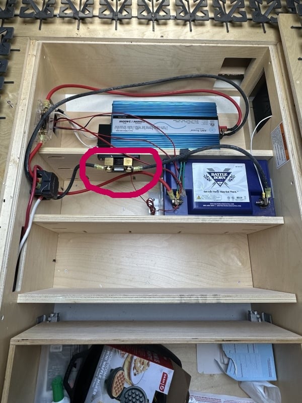

If its like mine, the actual shunt is circled in red above. The "Smart Shunt" Victron box I have seen I don't see here, but is that not a wireless Bluetooth connection to the shunt? You can clearly see the large black cable as the final connection to the battery, where it should be.2019 T@B 400 Boondock Lite towed by 2016 5.7L Toyota Tundra
floridaman The shunt is just to the left of the battery mounted to the plywood partition in your picture..

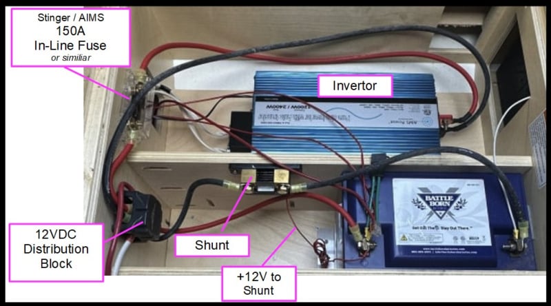

@floridaman by now you have found the Shunt Location . . .
Here are the other items in your Battery Box Area:
Adventures: 50 Nights: 415 Towing Miles 50,6501 -

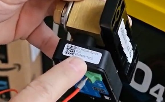

The SHUNT shown in the above picture and a few of the earlier replies is a Victron SmartShunt.
The PUK Code Label is located on the unit End, most likely the end facing the trailer front.
