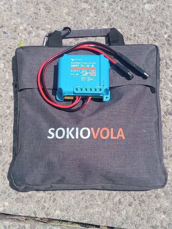

    My 120 watt back-up package.

    nuCamp sizes the Victron solar controllers that they factory install to the wattage of the rooftop solar. In most cases, there will not be enough room (edit: capacity) left for an additional panel. Buying a suitcase panel without a controller and adding a separate Victron controller mounted close to the battery has the advantage of reducing the voltage drop that results from the long wire run between the panel and your trailer.
    edit to add that the designation, like 75/10 on the controller stands for 75 volts and 10 amps. Exceeding the voltage will damage the controller, so you would have to be careful not to exceed the maximum combined PV voltage from your rooftop and a secondary solar suitcase. If you were certain that this would not be the case, then you could use the factory controller for both. The drawback is that it would never provide more than 10 charging amps to your battery.regardless of the amperage coming from the panels.

    The Zamp plug assumes you have a solar controller before the plug.  I preferred to have my controller safe from the elements not loose on the ground.  Also I wanted the same victron so I could see the status via bluetooth and form a network.  I added a second 100/30 victron MPPT next to the existing roof top solar controller.  If you wanted to do something similiar you could redirect the Zamp plug to go to this new controller or do what I did and add another MC4 port on the other side of the Nautilus.  This involved drilling and sealing the MC4 port.  I now use the Zamp plug just for my Victron battery charger
