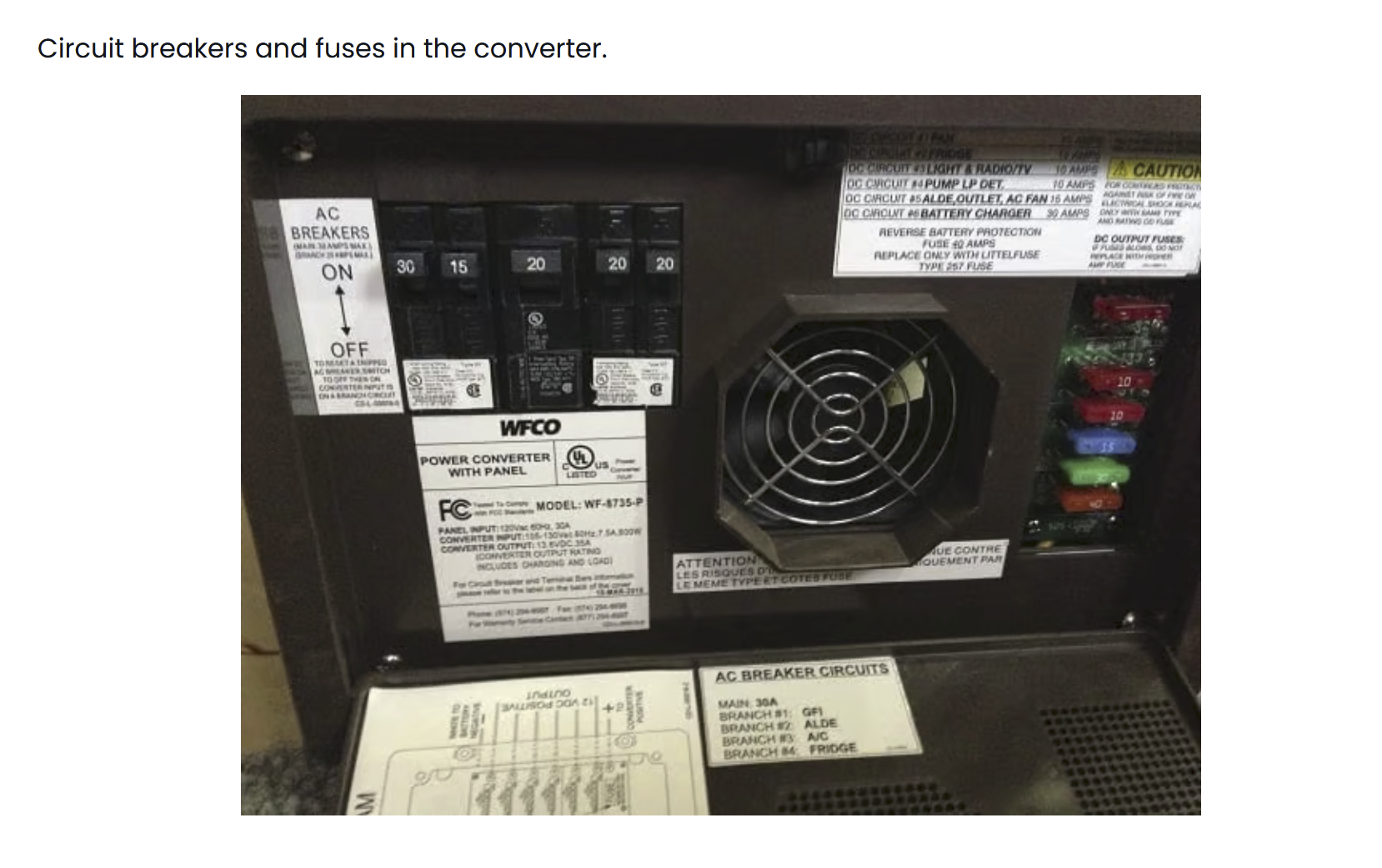

    This is the Fuses For Newbies file photo of the WFCO for around that year of trailer. The 15 amp breaker is listed as the GFCI breaker. There are lots of ins and outs about GFCI breakers that I will have to look for other threads, but….try to reset the GFCI with the trailer not plugged into shore power, and then try again.
    Here is more discussion concerning the GFCI circuit. There is one comment from MichiganMike that says his 2018 WFCO has different labeling for the breakers, so check what you might have in your particular model.
    No Shore Power to Trailer

    My 2018 320S 120Vac Breakers are:
    1. far left, 30A, main input breaker
    2. first to right, 15A, powers the Converter and the GFCI 'circuit' outlet(s).
    The 15A not resetting means the breaker itself is bad (low likelihood) or there is a short with the convertor or gfci outlets being the most likely failure point.

    @Lawyerboy, based on what you are describing, it does sound like a GFCI issue to me.
    If you are plugged in to your house electricity, make sure that a GFCI at the house on the circuit you are connected to has not tripped (but, seems unlikely since you hear a "beep" when you plug in the 30A AC cord, so power "seems" to be making it somewhere inside the trailer). You might have someone else stand inside the trailer as you plug in the 30A cord to determine what the source of the "beep" is.
    IMPORTANT:  A GFCI receptacle will not reset unless it has power, so make sure the trailer is connected to power when you attempt to reset the GFCI inside the trailer. However, if it is powered via the tripped 15A breaker circuit you referenced (which I believe protects the interior GFCI circuit), that needs to be working first so power can flow to the GFCI receptacle.
    Finally, if you have an outside receptacle, that likely has a GFCI, so check there as well.

    This narrows things down to a likely short in the single 120V AC circuit protected by the 15A breaker that won't reset. That circuit typically powers the AC to DC converter, as well as the camper's AC outlets. Note that a single GFI outlet is likely wired to protect other regular outlets downstream in the circuit.
